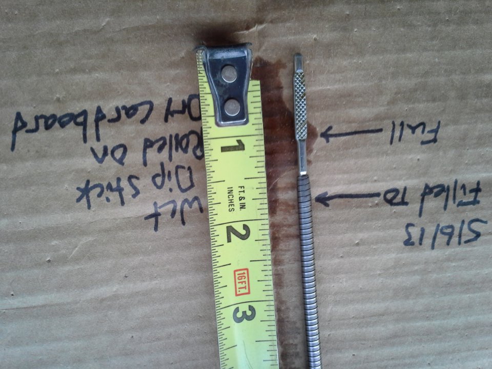

    So I took my 2006 Gen II prius with 185k to Walmart for an oil change, Ive done this at the same Walmart for 4 years with both my and my wife's 2011 genIII Prius. I request mobile one 5/30 and in the past they have always used individual Qrt's of oil and given me back half of the 4th qt in the mobile one container in a clear platic bag. Last oil change (the one before this one) they told me they had mobile 1 5/30 in bulk now and it was cheaper to do it that way, I said fine. Ok so I get the oil changed 3 days ago and I guess they used bulk mobile 1 again because I did not get back a any oil. I drive the 5 miles home, down hill almost all the way. The next afternoon I went to go shopping and jumped on the interstate for about 6 miles @ about 70 mph, then on secondary roads, after rising a steep grade and level off doing about 30 mph I noticed the red triangle of death, then realized I had no acceleration, I pulled off the side of the road and noticed the ICE was not running. Tried starting it and it did start idled as smooth as usual and go into gear but no acceleration, crawled about 4' and the ICE quit. I checked the traction battery on the display it was down to the last purple bar. I looked over the car and checked the fluids all good, oil was a little high. Pushed the car into a parking space, called a friend for a ride home and picked up some tools and my scanner, got on my scooter and went back to the Prius. Put the scanner on it and came up with P3190. So I googled it and did some reading. Noticed several posts about oil overfills and Walmart, I was caught off guard by these, never herd of oil overfill causing an engine that seems to be running fine just shut down. I checked the oil again and it was about 3/8" over the high mark now. I decided to call it a night and lock up the car and go home.
    That night I called Walmart and ask for the automotive MGR, told him what was happening and what I had read and observed, I told him I'd like to have it towed home so I could inspect the throttle body for oil and if found clean the throttle body and clean it. If that was the issue I'd bring him some photo's and the tow bill. He considered that and said he would prefer I have it towed to a Toyota shop and if the problem was diagnosed faulting a overfill Walmart would pay for the tow and the repair.
    The next morning I decided I'd just take some tools and throttle body cleaner and do it myself as I thought it would be well within my abilities to fix this, then I read where the same problem ended up causing another prius owner's car traction battery to fail from deep discharge. That gave me some pause but I carried on and purchased the cleaner and when to the car. I then cleared the code and tried to restart the car, it started but now would only go into neutral and would not accelerate. Started to get a little worried about what I had read earlier and decided to call Toyota and have them come get it, this way if things went south it would all be documented by certified mechanics my risk would be limited to Toyota saying it was not caused by the overfill and the tow and diagnosis costs would be mine. So I called them and the came and got the car.
    I went to the dealer and spoke to the service writer, he was familiar with the problem and said they would check it out and call be before the end of the day....That did not happen.
    Little bit after noon I called the service writer and he said they had looked at it briefly that evening and saw oil in the throttle body, also noted the overfill. He said they could not get it to start and then he dropped this little bit of info. He said they have had to replace the entire ICE due to this problem, did one just a week ago due to a Walmart overfill, they would get more into it this after noon and they would call me latter today....that did not happen. So I'll call them tomorrow but its inconceivable to me that maybe an extra 1/2 qt of the spec oil driven maybe 12 miles could total a ICE, especially when it seemed it showed no signs of problem, idled fine but seemed to be limited and shut down by the ECU.
    While I'd be OK with a new ICE and all that comes with it, I'm not comfortable with anyone getting shafted for this even if it's the largest retailer in the world, fair is fair and that's what I want for everyone involved, lord knows I've made worse mistakes in my businesses and appreciate they be rectified honestly. I'll call them tomorrow and see what's up and post an update.

    toyota has overfilled all 3 of my pri by a half quart at every oil change and it's never been a problem. i've never had 185,000 miles or driven 70 mph though, so maybe that has something to do with it.

    Could the overfilled oil have foamed due to the high rpms at 70mph and thus blown into odd places on the ICE? Just guessing but I have heard of that happening in the old days-oil foam would appear in the breather cap, and I think seals were often blown out resulting in crankcase leaks.

    My 2 cents: it's very improbable a 3/8" oil overfill would shut you down.

    Yeah mostly you'd just end up with oil messing up the throttle body, but there can be more serious results in some cases. With a really bad overfill some engines can get breather passages blocked. So you get like an air locked pocket in the sump that can get pressurised from blowby gases and blow out the main seals.
    Also if the oil gets really badly foamed up you can end up pumping mostly air (most of the foam is air). So ironically an oil overfill can actually lead to a kind of oil starvation.
    The Prius can be a bit misleading here. The electric motor (MG1) will crank the engine nice and fast, what may seem like a good smooth idle, even when the engine isn't firing properly. Eventually it will work out that the engine isn't delivering power and give up and throw a code.

    Oil starvation isn't going to immediately "shut you down" like that. Oil starvation would have probably caused severe knocking from connecting rods and probably a cloud of smoke behind you as the piston rings run dry. This has been my personal experience with oil starvation with one of my track cars.
    MG1 being able to crank the engine means the engine isn't seized yet.
    There must be another issue causing it not to start. Unless your engine was making all sorts of racket before it shut down, it's more likely it's a component supporting the engine that has failed.

    So I call the dealership talk to the service writer, he said that the lead tech has yet to get back to him and he's not working today but that they will most likely have to contact the manufacture to get approval for a engine (ICE) replacement..... I really feel as if they are building this case for a new ICE with little work being done to really find the problem, and again I think its as simple as the throttle body needing to be cleaned, at least that's where I think they would start. I'm pretty sure the ECU was responsible for shutdown, did not feel or here and vib, knock, hesitation. Could be the butterfly was stuck too. As the car is fly by wire on the throttle either could be possible, I guess I should have reached down and tried to advance the butterfly on the outside spring to see.
