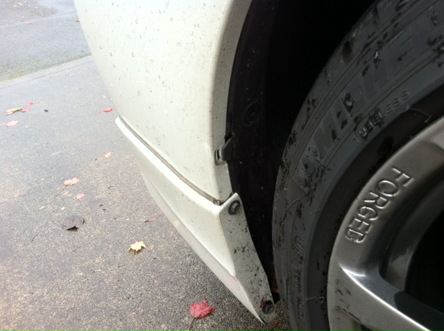

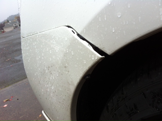

    My wife came home with this, said she had an issue, but didn't explain how it happened.
    I'm not a body guy, and it looks like there is a hook that needs to reattached, but I'm not sure how to do that, anyone have any suggestions? Prius rear facia 1.JPG Prius rear facia.JPG Prius rear facia 1.JPG Prius rear facia.JPG

    did you try to push it in?

    Going to need some new plastic clips. The old ones probably sheared when the car got "bumped."

    She probably bumped the bottom edge of the bumper on a parking space stop which was higher than the bottom of the bumper.
    Happens quite often with the Prius.

    This is the first thing I'd try. When doing things to other cars, including removing panels while adding a hitch to another household car recently, many of those clips can be popped without shearing them, and can be popped back on. But not all, I've needed to buy a few replacement clips.

    The bumpers are usually held together by clips, you can probably straighten any connecting clips that looks to be crooked and push the bumper back into place. If anything, there would be 1 or 2 bolts holding the end of the bumper. The rest are just clips

    I'd suspect the bottom lip of the "bumper" (really just a fairing) snagged on some wheel stop curb when pulling away, tried to pull it out, in the position it's in now. Obviously not gonna solve the problem, just an observation. I think it'd be best to remove it completely, see what's happened to to the fasteners.

    It's happened to me... From the pix it looks like it should just snap back into place. At least try that first...

    I went out yesterday, took the rear wheel off the car and removed the two sheetmetal screws. I was able to pull the cover off the plastic shield it was attached to and one of the J hooks from the shield had popped off the body. I was able to pop it back in place, then snap the cover back into place.....................so all is good again. Because this has the PPE factory option is sits pretty low, and although I didn't get under the rear cover to see if the bottom was scraped, I think she got the bottom of the cover hooked on something and it pulled the front edge of the cover out....................just a guess and she says she's not sure how it happened......................I'll leave it at that. I also noticed that the right front of the front spoiler (the piece that is added on for the PPE option) is pretty chewed up from rubbing against something like a parking curb. I would replace it but don't see where you can buy single pieces of the $750 body kit, and Toyota only sells the complete kit, not parts. I bought the car because it looks really nice with the 17" wheels, lowered (my 14 TracPak Mustang is also lowered) and the body kit looks perfect.
