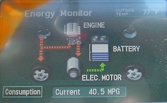

    You should see power going from the ICE to the wheels and from the motor to the battery. It should look like this (couldn't find one for a C)
    On a flat surface, going 35-45 mph (steady speed and not accelerating) you should easily net 60+mpg's in this mode. If the battery gets to 6 bars, ease off the throttle and use some EV until it drops to 3 or 4 bars. Then reengage the ICE to maintain speed and charge the battery (done by pressing on the accel until the ICE fires back up and easing off until you get the arrows as stated above).
    If you're driving short trips, use the first 5 minutes to charge your battery to six bars using this technique.
