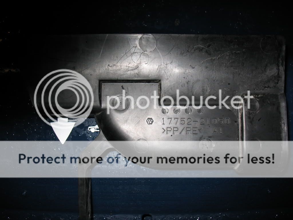

    Anybody know what this Part 17752-21050 is for? Is this the Winshield Washer Fluid warming vent or what?
    I pulled this out today, because I saw a bunch or rubber banding type material that seemed to be kind of randomly stuffed behind it. I figured out the rubber banding stuff was covering for the cables that go the headlight leveling things.

    17752-21050 is the inlet for the air cleaner. MSRP is $26.89.

    The air inlet faces back toward the washer tank so it won't catch incoming spray and the engine breathe water. I saw all the water on the black front cowl on your brace install pictures.

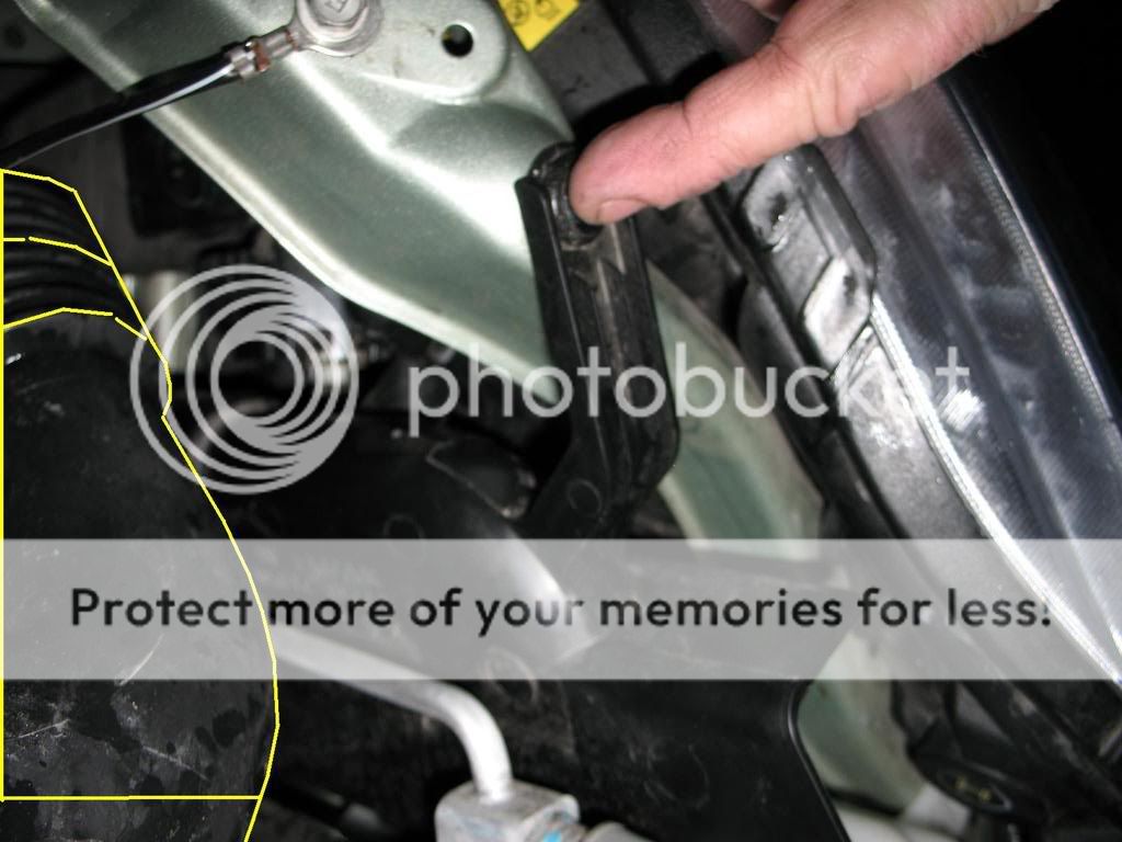

    But I thought this accordian looking hose I outlined in yellow was the air intake for the air claaner.[​IMG]
    Yeah, I did get some water in the cowl tray, becuase some beautiful Northwest Sunshine fell out of the sky while I was working.

    Item Number 1775221050
    Engine / transaxle - Air intake - Duct
    Duct 2004 - 2008
    MSRP $26.89
    Core Price $0.00
    Price $21.51
