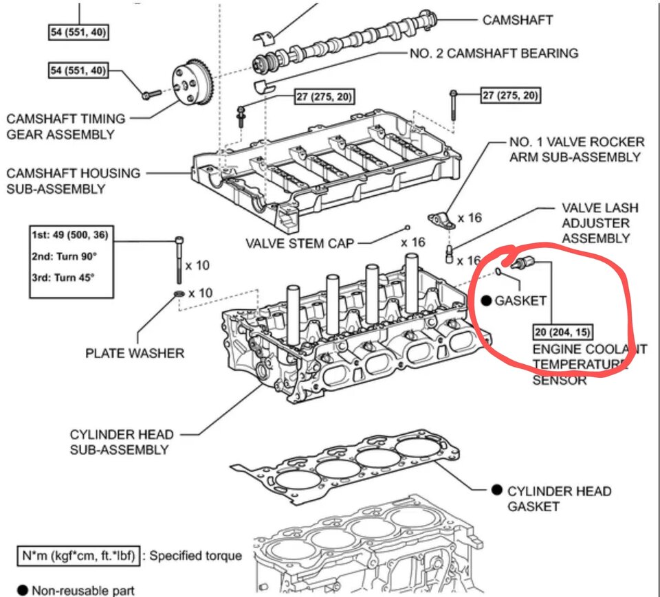

    Image attached.
    I screwed up the wiring harness side connector when trying to remove it. I'd like to just tie in a pigtail / replace the connector.
    Bonus if you can confirm which temp sensor that is (part number). I may just replace it but it looks like there's two different ones.
    Thanks!

    It should say something or there should be a code next to each of the temp sensors that denote whether it's federal or another market or something none of the cars had a gauge so it won't be anything like that maybe the difference is between 0405 and 0609 something along those lines I would think both of the connectors that plug to the car on the end of the sensors would take the same plug do you need one of these plugs I do believe I have a few but are intact and work I think they're Gray but this is for the engine temp sensor on the back of the cylinder head you can have the sensor if you want it too it doesn't matter to me but I do have the plug and I can look up and give you its Toyota number I'm not sure where you're going to buy it
