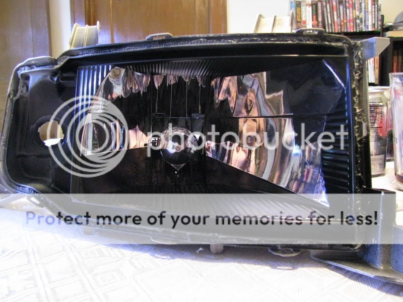

    If you want to make them appear darker, the best option is to bake the headlight and spray the interior of the housing black.
    I did that on my old xB headlights. (and yes, I know that I painted part of the reflector, this was actually to combat H4 HID glare and create a cutoff before I got my shielded bi-xenons... it actually worked quite well)
    I don't have a great pic of them reassembled, but they did look quite a bit darker than stock.

    Easier said than done, the Gen III Prius comes with a completely sealed headlight assembly. The only way to open it is to bake it in an oven to loosen the seal and then pry it open. Then you have to bake it again to seal it back.
    Afterwards, you may have issues with the now damaged seal.
    It's something that's possible:
    DIY: How to black-out the headlights on a 2010+ Prius | Balancing Act
    But I'm certainly not going to try.

    Yeah. Baking it really isn't that hard. I'm tempted to try on the Prius, but I'd certainly try to source a backup set of headlights.
    200 degrees for 15 minutes is enough to soften the adhesive enough to pull the lens. I've done half dozen or so xB units and never had a fogging problem.
