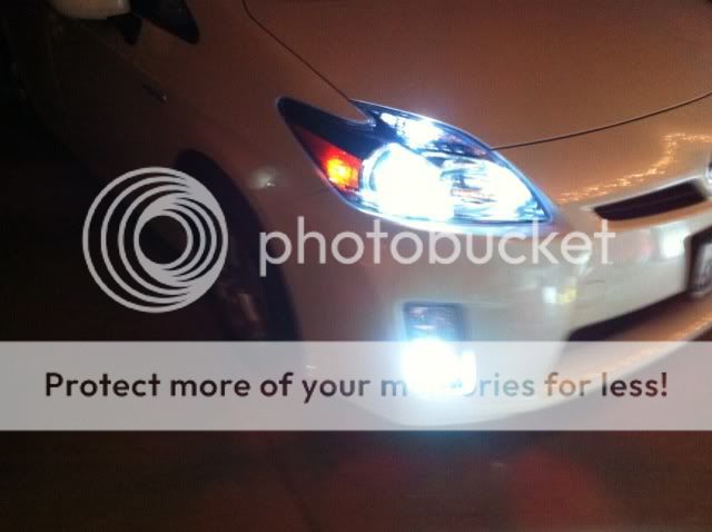

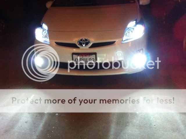

    just installed my second set of hid in the pc foglights.....
    i also change my parking lights to led.....so now this is what she looks like......
    [​IMG][​IMG]

    Looks sick!!! I went with 5000K- those pics make me want 6000K. Oh well.
