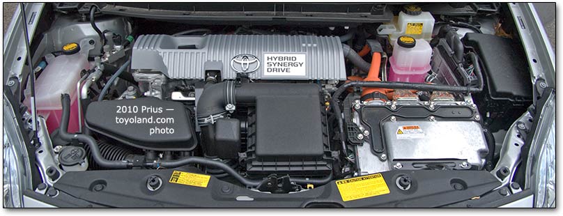

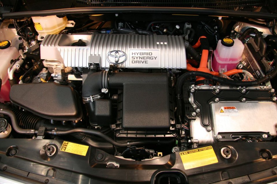

    do the two differ under the hood ?
  14. GrumpyCabbie
    GrumpyCabbie Senior Member
    Dec 14, 2009
    6,722
    2,121
    45
    North Yorkshire, UK
    I believe the lhd brake fluid reservoir is on the right hand side so as to be on the same side as their steering wheel. Otherwise I think they're pretty much the same. I know on my rhd car the brake fluid reservoir is crammed in to a small space above the coolant on the lhs and the rhs of the engine bay is empty.
    Someone's going to have to take a picture of a lhd and rhd car so we can all compare. Who's it gonna be? :)
    hsnmz likes this.
  15. hsnmz
    hsnmz Junior Member
    Jan 28, 2013
    74
    Pakistan
    I'll be glad to put up the pic of my RHD once I get the delivery by the end of this month. Anyone for a LHD under the hood pic ?
  16. hsnmz
    hsnmz Junior Member
    Jan 28, 2013
    74
    Pakistan
    googled. Can't tell which is LHD or RHD
  17. GrumpyCabbie
    Dec 14, 2009
    6,722
    2,121
    45
    North Yorkshire, UK
    Top one is a RHD (as it looks like mine except it's a lot cleaner) and the bottom I guess a LHD.
