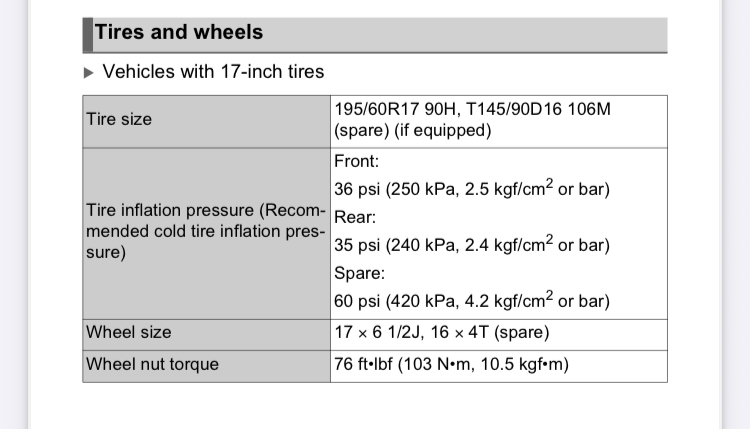

    42,146
    Perhaps, but it’s not what Toyota spec’d:

    True.
    The Toyota spec is for a size barely present in our market, but 215/55/17 will fit the wheel and is a size for which Tire Rack has over 100 choices.
