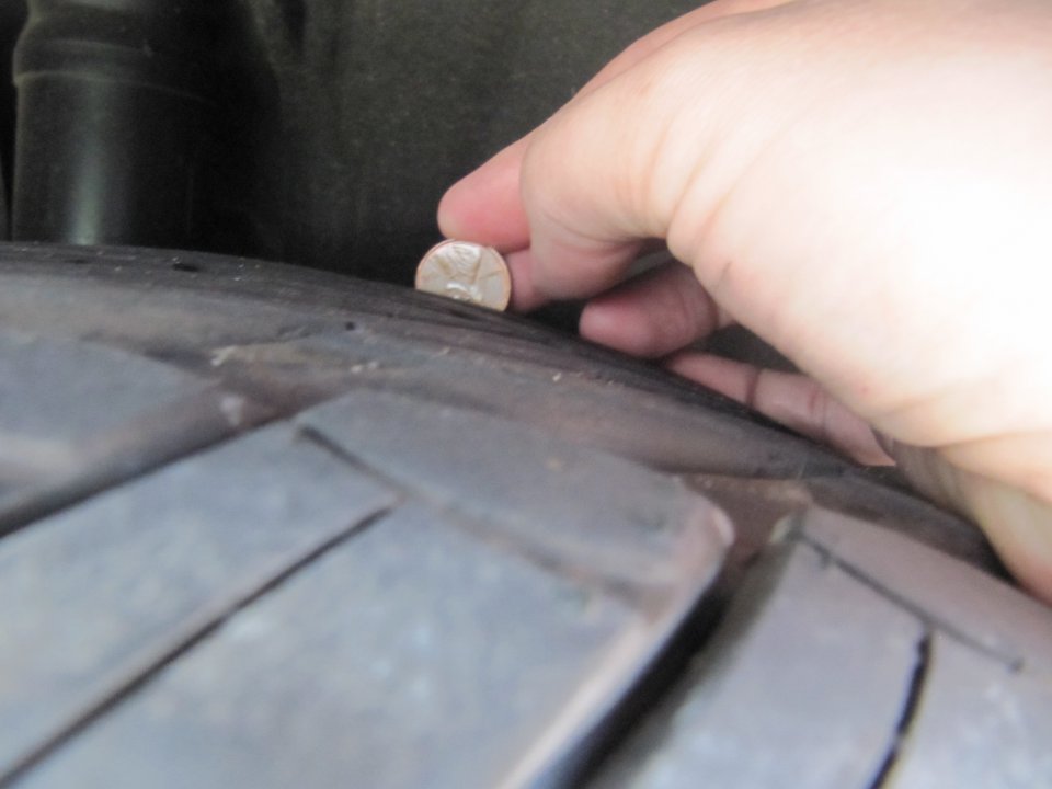

    I don't know how to tell because on these they have huge grooves in the middle bit sure if I'm checking right. I use to always just stick a penny in the tire.
  4. F8L
    19,011
    4,081
    Grass Valley, CA.
    You can use a penny. Just stick it in each of the major grooves starting at one edge of the tire then move cross the surface to the other edge. If you can take can take pictures that would be helpful.
  5. ilovemymac
    ilovemymac Member
    Mar 7, 2013
    170
    Gardner, KS

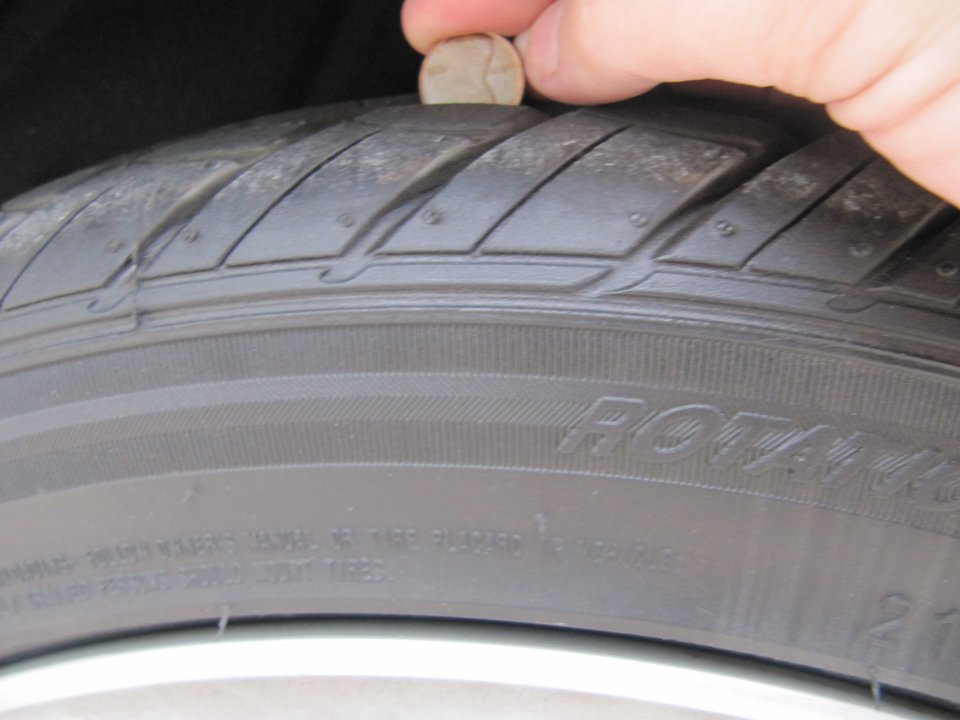

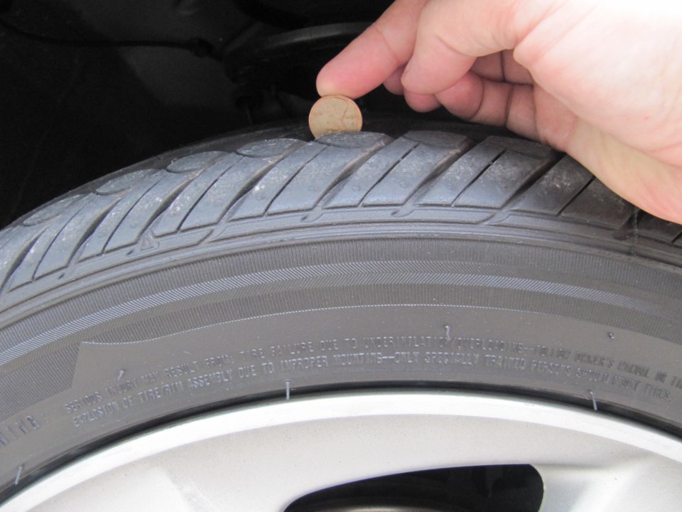

    OK here ya go. The last one is the back tire the other 2 are from the front tire.
    Thanks again guys for the help.
    F8L likes this.
  6. F8L
    19,011
    4,081
    Grass Valley, CA.
    That is still a decent amount of tread left. You may gain 1-2mpg by switching to a LRR tire but I'm not sure it would be worth it economically. Unless your fuel economy is really low right now or you live in the Pacific Northwest with tons of rain I'd probably just run them down and then replace them with something better. :)

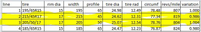

    How about: Bridgestone Ecopia EP422, in 205/50R17
    The above's just my calc, based on the stated tire sizes. There will be slight variations.
    The Ecopia EP422's a readily available, decent LRR tire. The alternate size, suggested by F8L, will improve things further, with the narrower footprint and larger O.D.
    The larger O.D. (very slightly larger than stock 15") will improve the "gearing", I think. OTOH, the car will slightly underestimate how far you've travelled.
    The EP422's also available in 215/45R17, if you want to keep it completely stock.
