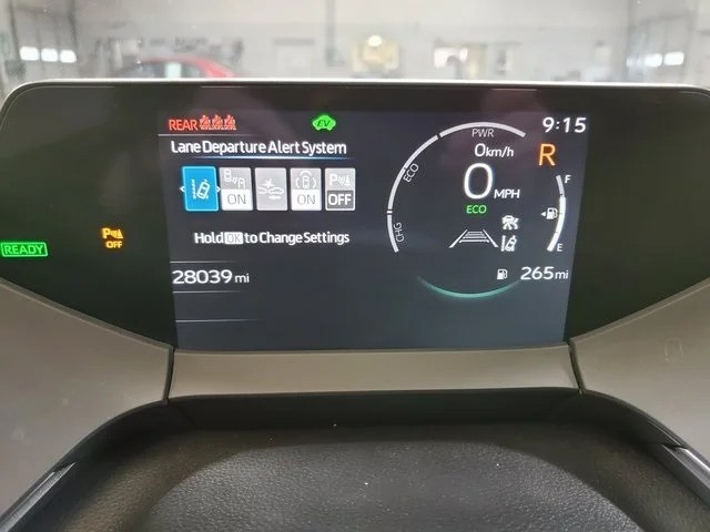

    I was at a dealership that wants $25,822 for a 2023 Prius LE. It's been in a "moderate" accident involving the front right bumper, but no damage to the frame.
    I test drove it, and the yellow parking sensor light was always on on the left on the screen infront of the steering wheel. It also made no noise whatsoever, and both I and the dealer tried to turn it on, it wouldn't. We could go into the settings by holding OK, but not turn it on, despite going through the manuals. Does this mean that there's a problem with the sensor, or did the trim just not come with it?
    Also, it says on the brochure that the Front and Rear Parking Assist with Automatic Braking (PA w/AB) is an option you can have with the trim for $35. Can you install it afterwards? It didn't seem to come with it and the rear camera didn't shift the trajectory of the vehicle, it was static.
    These are some features that I really want to be in the deal, and I really appreciate any advice or knowledge. I do see myself getting this car, but maybe not if these two issues can't be fixed easily if at all.

    The yellow light means the Intuitive Parking Assist system is disabled for some reason. And if it's on, that means the car came with the feature but something is now wrong with it.
    It could be a faulty sensor(maybe an original sensor damaged in the accident or during the repair; or maybe a crappy aftermarket sensor the car doesn't like), could be damaged wiring, could be they didn't recalibrate the sensors after the repair and the car knows it.
    I'd never accept the car with a warning light, and I'd probably run away in any case. At the very least, the fault would have to be fixed, I'd need to see proof all repairs were done with OEM parts, and I'd want to take it to a 3rd party shop for an inspection to check the quality of the repairs.

    The car likes turning on yellow lights whenever a function is manually disabled - it would show the same yellow light whenever you turned the parking sensors off.
    But the fact you can't turn the parking sensors on means that there is a real problem.
    And you have to question the quality of the repair - if it was supposed to be repaired, why didn't they get that working? What else did they skip? Or maybe they didn't skip it, and their repair failed. Neither of which inspires confidence.

    Look at the back bumper and see if it has the little round sensors in it (the parking sensors). If the back has it and the front does not, they replaced the bumper cover with one from a model that doesn't have the parking sensors lol. I can't imagine anyone actually doing that but who knows.

    The parking system most likely won't activate because there is a fault. Based on your description it could be a damaged sensor or a wire in that corner that took the hit. Those sensors are extremely expensive which is why probably why they are trying to avoid replacing it.

    Eh, depends on what you consider extremely expensive. The ultrasonic sensors run about $130-140 on sale. Add another $15 per sensor if you also need to replace the retainer that holds it to the inside of the bumper.
    Now if you need to replace one of the millimeter wave radar sensors, those get more expensive. But I think the only one of those on an LE is in the center of the grille for the adaptive cruise control, and that system isn't giving errors.
