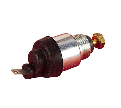

    Has anyone had experience using solenoids and know how strong they are? I posted this in the other thread, and was hoping to get some feedback before I started spending money on "experimenting". Also, I'm seriously thinking about using a solenoid like this "laterally"; meaning that it sticks out from the side, just enough to block the very top of the pedal from returning to zero; in which case a 2nd solenoid could also activate to limit the max throttle position to the optiomal "pulse" position of approx 38%. Just a toggle button on the dash would stick both solenoid shafts out, giving the driver upper and lower throttle stops; all he has to do is use his foot max/min to pulse/glide optimally. I'm hoping to get a suggestion on a solenoid, or some kind of sturdy lateral shaft/piston assembly that could push out, but hold its position accurately with the heavy lateral load of the pedal.
    (as a "glide" throttle stop) What do you guys think of this? I'm wondering if this would be strong enough to push on the top part of the plastic throttle pedal lever near the top pivot. Up there is out of the way, but requires the most force because of the leverage. Also, do you figure it would be Ok to energize a solenoid like this for long periods of time without concerns of overheating or electrical consumption? This one is designed for A/C throttle usage so I am assuming it would be.
    The other idea I had with using a solenoid for this mod was to have it come in from the side, just enough to block the pedal from returning to zero. This would require something to hold force laterally, with enough precision to get it in place. Also, if greased, it may be possible for the solenoid to spring back into off position. Any suggestions on hardware that would work for this?
