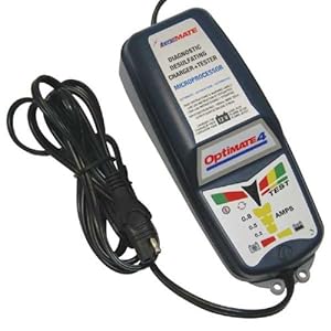

    We have an Optimate 3+ at our CO home and an Optimate 4 at our AZ home. They are "smart chargers" meaning they test the battery periodically and top it up if it gets low.
    We used them during winter storage of our motorcycles for years and now use them on the Prii when we're away for any length of time. They work great - just plug in and forget. You can get them on Amazon for $50 or so.
