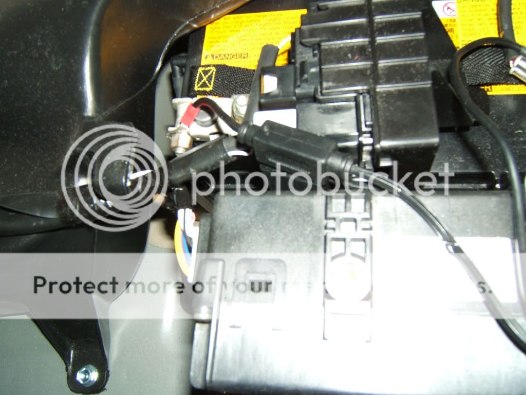

    Your post has classic symptoms of a low 12 vdc bus, especially the warning about "park pawl abnormal." The first winter I had my 2004, the 10-15 minute commute at -40, constant use of headlights, Max Heat, and constant electric defrost, all dragged the 12 vdc battery down enough to cause weird problems.
    I solved all those weird problems by hooking up a VDC Electronics Battery Minder directly to the 12 vdc battery
    and leaving it plugged in overnight when the Prius sat in the underground heated parking at the condo I used to have.
    A battery with a shorted cell can be one symptom of a battery that is badly sulfated and actually overdue for replacement. Since the Prius doesn't use the 12 vdc battery for cranking the motor, it's a lot smaller. You also don't get the typical warning symptoms until it truly dies
    Thing is, if a cell is shorted, you will usually never have over 7-9 vdc. Maybe SKS might work, but I don't see how the car could boot up. But a badly sulfated, old battery can recover a bit if left to sit for awhile. Best option is to replace it
    I'm hoping they properly bled the inverter coolant circuit when the pump was replaced. I guess you'd know by now if they had not! I'm also hoping they fully charged the replacement battery before installing it
