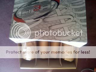

    First thing that came to mind when I opened the box was sorrow for the poor guy who individually wrapped these springs and puts them in a box hahaha. But big props to B&G for making sure that these springs don't get scratched before I do:)
    Once all the wrapping was off the springs I noticed their quality powder coating.

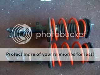

    Whoever worked on a Prius before knows that Its not fun. Removing the factory struts is a pain. But other then that the springs were a direct drop in replacement. There was actually enough preload on the springs to insure that they do not move during installation or if someone ever decides to jack the car up.
    [​IMG][​IMG]

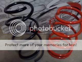

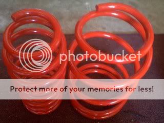

    Comparing the factory springs with the S2 springs would be easy. The S2 springs are slightly shorter with thinker stiffer coils when compared to the factory coils.
    [​IMG][​IMG]

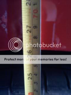

    Appearance:

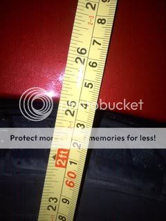

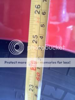

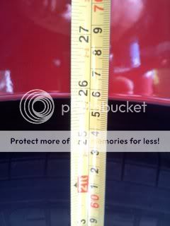

    B&G advertises that the S2 springs will lower your car 1' in front and 1' in the rear. What I did notice that there was actually 1 1/8' lowering in the front. BIG WHOOP:rockon:
    After
    [​IMG]Before[​IMG]
    After
    [​IMG]Before[​IMG]
