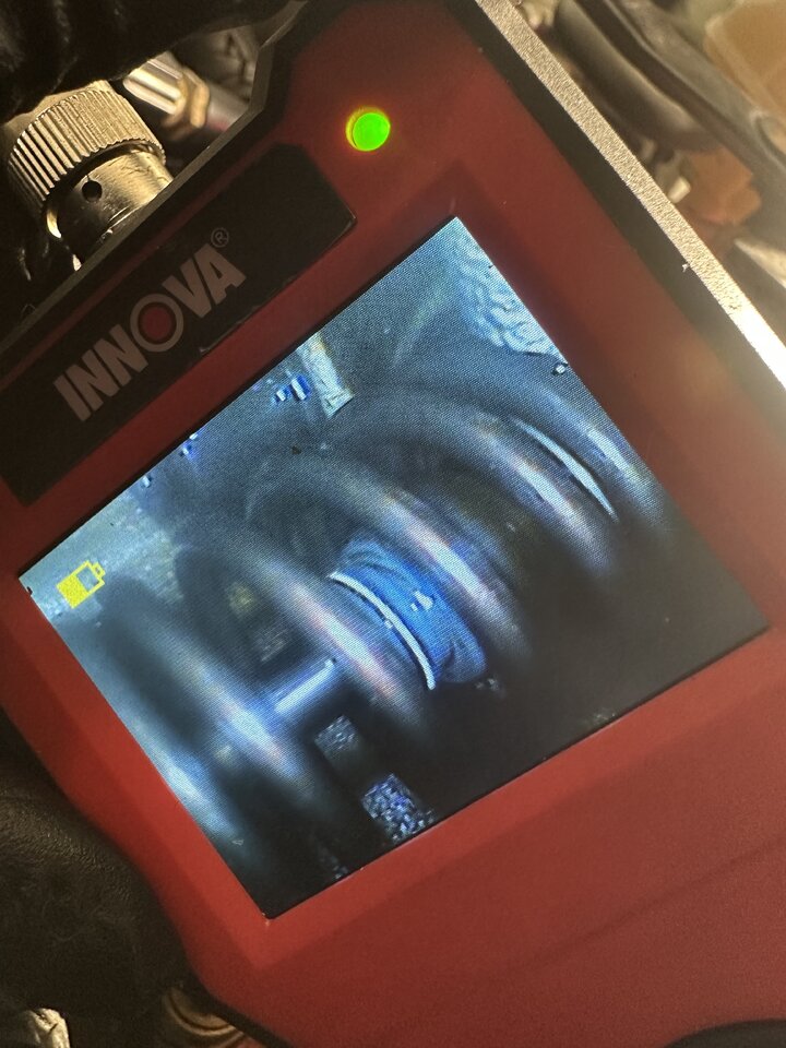

    changed my headgasket earlier this year 15k miles ago. I’ve been having oil consumption and began getting a P0304 at high acceleration. I pulled the plugs and found oil fouling on cyl 4 and slight fouling on cyl 3. I opened the valve cover to check the valve stem seals. This is the one on the left intake valve for cylinder 4, viewed through a cheap borescope for angle. I can’t tell if it’s torn/deformed and I’m trying to tell if there’s a better way to check it without pulling the head off again. Thank you!

    Hard to tell from that photo.
    How many total miles on the engine? Oil burning is an issue with these engines.
    The only way to fix it correctly is to replace the pistons and rings with the updated ones.
    Or a short block, or engine...

    Mhmm. 192k miles. It could be pistons and I’m concerned, however I strongly suspect the HG job was the trigger for the oil consumption. I was able to check the seating of the valve stem seals and seemed ok.

    On a gen3; oil consumption is usually a problem with the low tension piston rings - though the valve seals are suspect. Whomever did the head should've replaced them as a preventive measure while it was out.
    Bottom-line, the oil can be coming from the bottom-up or the valve seals, top down. Since we don't know the history; you'll need to figure that out before proceeding. You can't always determine an issue by visual inspection ONLY.
    Good Luck

    hi I did replace them when I did the head. They seemed to be in place but I have concerns now. For example one tore when I put the valves in so I had to get more.

    Valve stem seals are usually pretty robust and takes a LOT of effort to cut or tear. None of the valve stem ends should be sharp enough to do that; otherwise they should've been wire wheeled to smooth out those burrs and sharp edges before getting pushed through the head. A very light touch of assembly grease would also help.
    Just my opinion and the way I do things......
