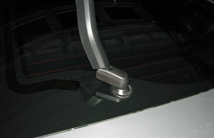

    Darell's got a nice pic of the mod.
    Go to EVNUT.com then check the Prius pages, then the mod pages. Basically it's just a matter of snapping off a tab. here's his pic:
    Simple !
