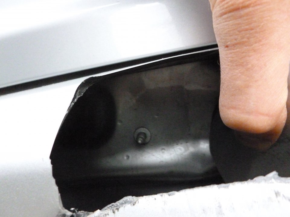

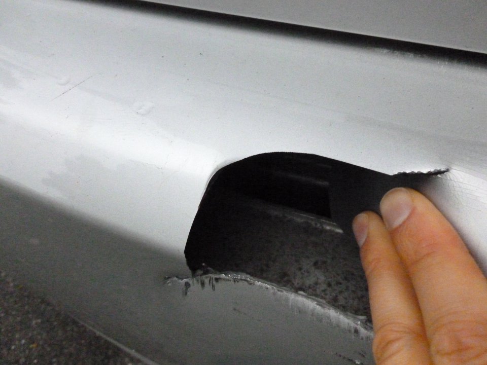

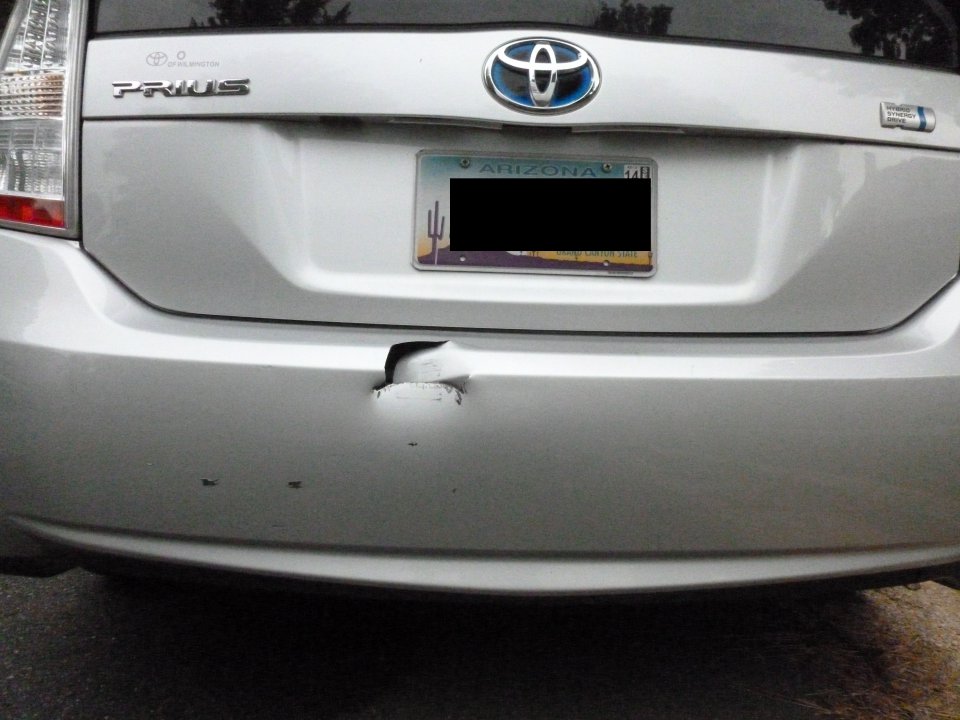

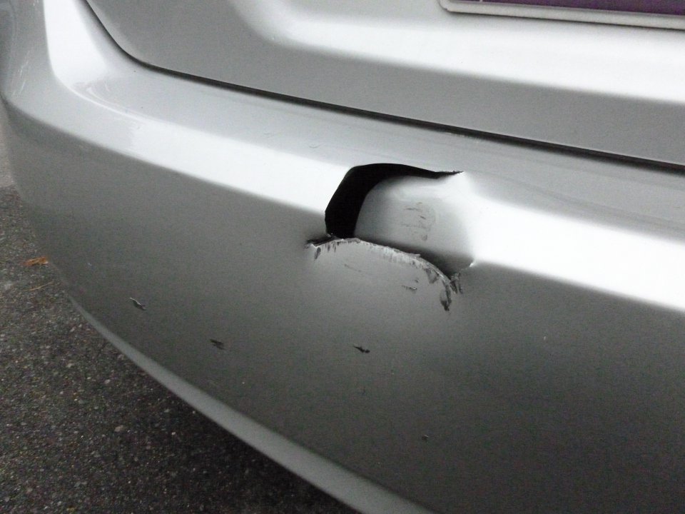

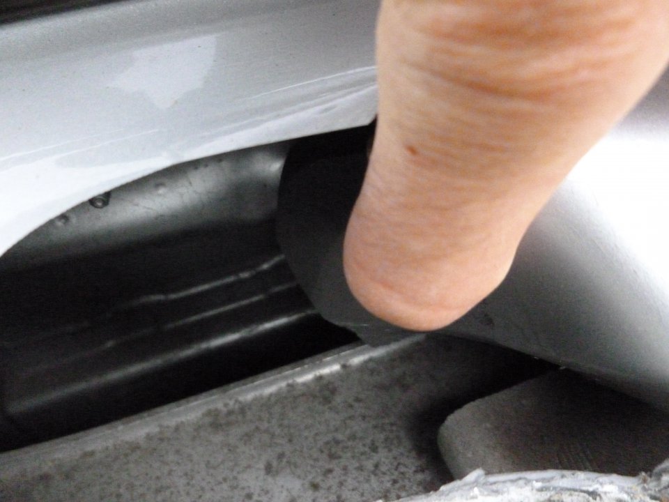

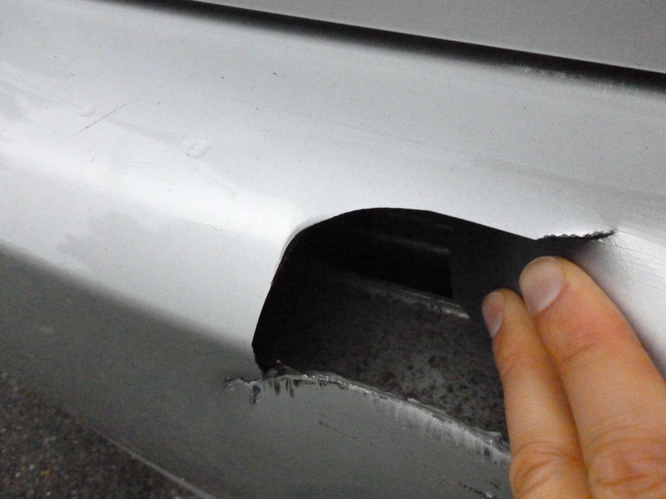

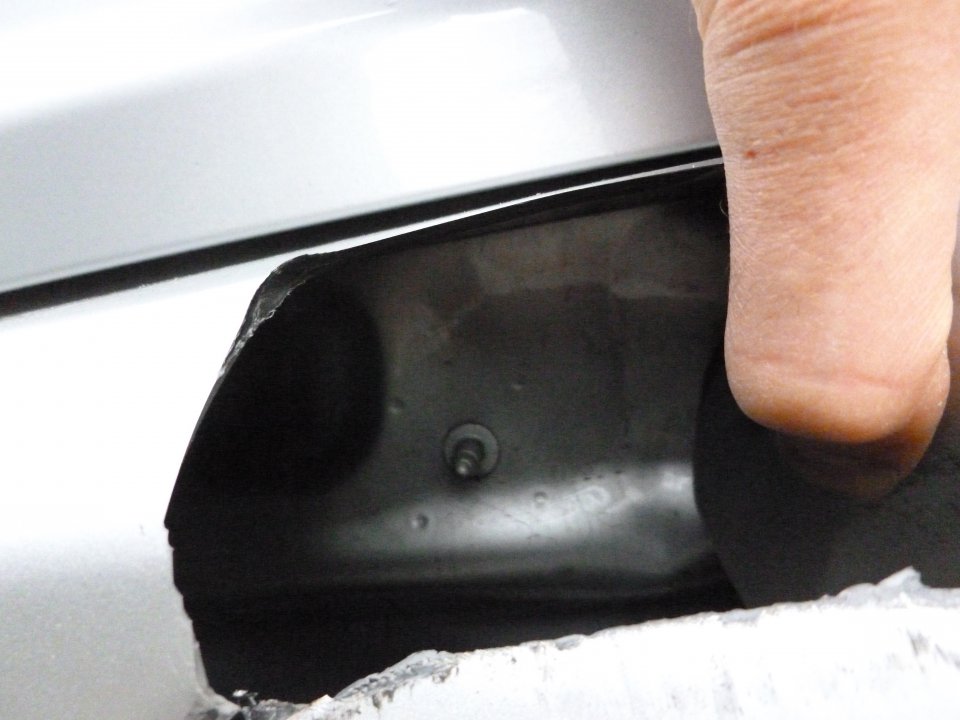

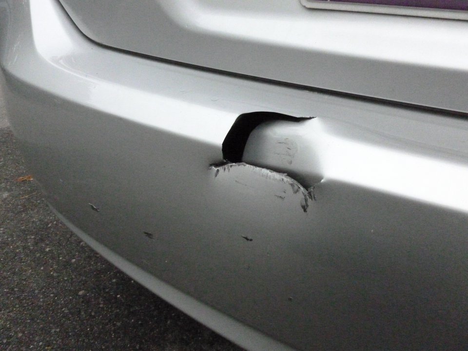

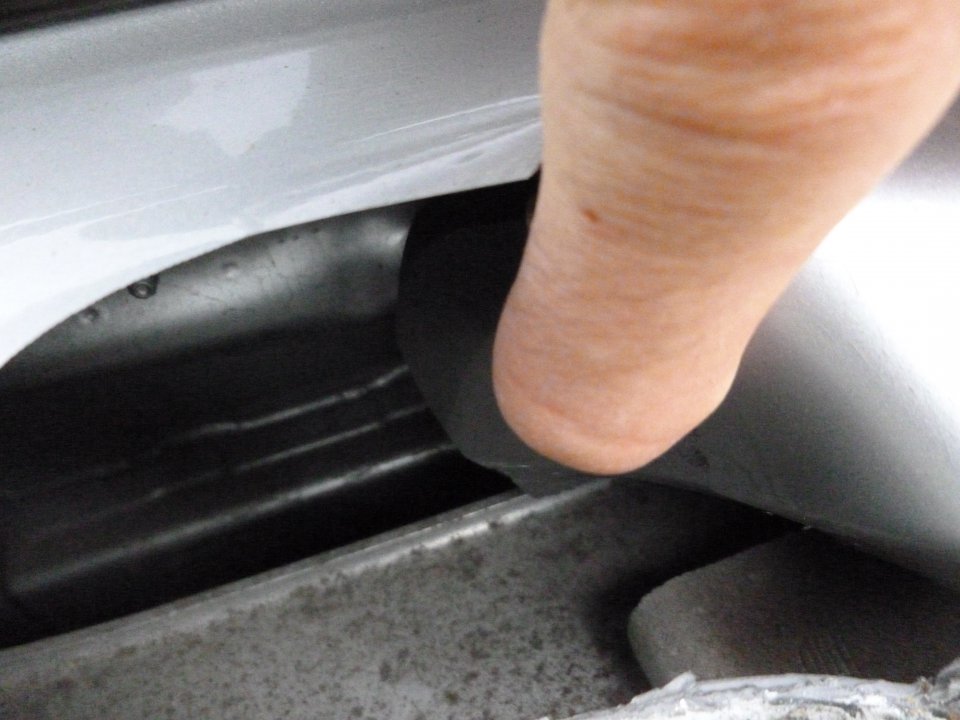

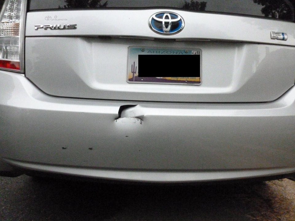

    P1010998.JPG my wife backed my baby into a parked trailer, and punched about a 5 in x 3 in hole in the back bumper. It's on the "crease" where the bumper transitions from vertical to horizontal, pics attached.
    My concern is that rain water will come straight in from the top side of the hole and collect inside, possibly causing problems. The metal is what the plastic bumper is up against, so i'm guessing it's the frame, and protects your rear end during a collision.
    If I don't fix it, might I run into problems?
    I'm trying to save money, not buy a new bumper, but if the risk outweighs the savings, then I'm gonna suck it up and replace it.

    I would take the bumper off and do a fiberglass repair from the back side after massaging the broken piece back into place. Then smooth the seams of the break on the outside with some grey silicone.

    Water (and any salt contained therein) will splash up inside from underneath. I don't think it's a rust issue, just cosmetic.

    If not sealed properly, the eps foam energy absorber between the bumper cover and the aluminum bumper will deteriorate and lose it's energy absorbing properties.

    I recently got my Pri back for a destroyed cover, bumper frame and other - there is a metal strut under the cover with some foam. The cover itself (new) was listed at about 900.00. Here's the thread and the pics are near the end of page 1.

    There won't be a risk of rust , the area right behind of it is foam and aluminum beam . There is no exposed of bare metal. So no. But sure looks ugly...
    Best bet is to search craigslist or other places to get a good condition used replacement (if budget is an issue)

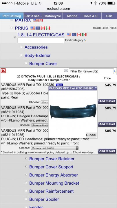

    Try rockauto.com. Get it painted then install.
  12. Mendel Leisk
    58,963
    40,586
    It might be better to install, then paint. And extend the paint a bit into adjacent body panels, what they call blending, where they gradually thin out the color coat. Frustrating to have to repaint half the car, but that's actually the best way to avoid an obvious transition.

    Good thing the trailer tongue didn't hit the hatch or you'd be looking at a bigger repair.
    My concern wouldn't be with water getting in the hole but rather with hatch wall having paint damage around that dent & getting rust
    You could do 1 of 3 things:
    1) Buy a new bumper cover and have it painted
    2) Buy a used bumper cover in the same color
    3) Buy a used bumper cover any color and have it painted
    If it helps, I have a 2012 blizzard pearl rear bumper cover that I can sell you.

    Having replaced my rear bumper cover twice I can say without hesitation do not buy the $100 bumper cover. The plastic is so thin it looks pretty bad on the car. I went that way the second time and highly regret it. Buy a good condition used bumper and take it to a body shop and its $150 to have it painted. Must be painted off the car.
    It looks very much like a G2 bumper which is fairly easy to take the rear cover off and uses alot of clips along the bottom that may break off when you pull the cover off. Buy new clips online before hand.
    All in maybe $250 which may be cheaper than your insurance deductible.
