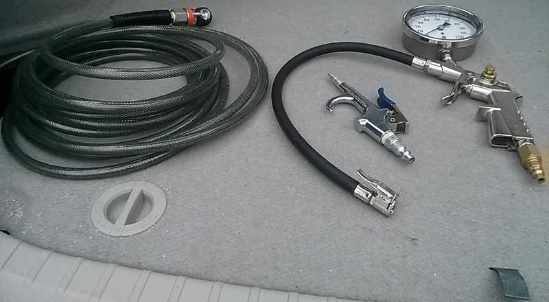

    I had one of those little inflators once, but I eventually wired a larger compressor into the car instead. That solved a few things that used to annoy me:
    • There's no TPMS in the spare, and I'm really bad at remembering to regularly check it. When I wired in the compressor I just set it up to keep the spare at 60 psi, out of sight, out of mind.
    • Instead of a little slow inflator to plug in and lug around, I just have a coiled-up air hose living in the small storage bin off to the left of the hatch area. It's always connected to the spare tire, which is always 60 psi. That'll top off any of the four lower-pressure tires in seconds, just push the chuck on and squeeze the trigger, much faster than the typical small inflator.
    With a blow gun on the end it's also great for blowing tree gunk out of gaps and under the hood, etc., and a few times I've used other small air tools (but only for very light work).
