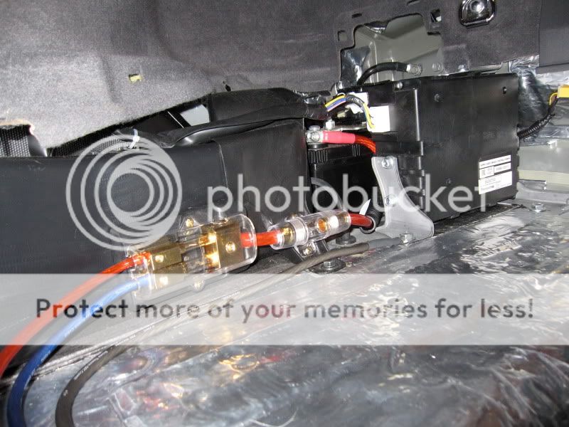

    Ok so here are a few photos to give you an idea of whats going on in there then maybe you guys can tell what you think.
    Here is the amp which sits on a board above the tools and the wires feed directly under it.
    Now you are looking at it as if you were under the amp and looking forward towards the seats. Here it looks as if the ground wire? black with pink tip is attached to a bracket?
    Now you are seeing the wire from the side.
    It looks like the RCA's (blue?) run to the driver side left, and there thick red wire runs to the right.
    Sorry Im so noob with this, I need to learn this stuff so I can troubleshoot these things.
    Here is a link to the album I am using in case that is easier because I seem to also be noob at linking photos
    http://picasaweb.google.com/ejmckee/CarPhotos?feat=directlink

    Yeah, looks like they ran the RCAs on the driver's side. I would look into swapping sides and putting them on the passenger side. Maybe running so close to the high voltage hybrid cable is causing your noise. I caanot guarantee that but I have zero noise, not even a slight hiss between tracks and I ran mine on the passenger side.
    Thankfully the sill plates come off easy so the only hassle is removing the head unit to get access to the wires. :(

    Agreed. I'm also not too crazy about including the traction battery case in the grounding point. Can't say for sure it's a problem but I wouldn't have done it (and didn't!). Otherwise, the amp looks nice and tidy in there, very slick.

    Aye. I used the factory 12v battery grounding point for one of my amps. Forgot where I grounded the other. :)
