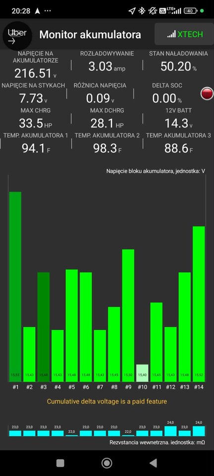

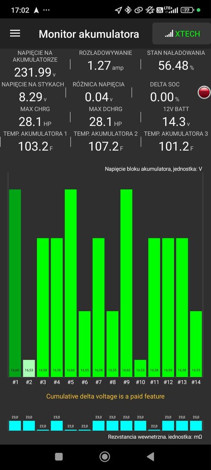

    I got a 2013 toyota prius 3gen, 5 day ago my mechanicien change my brakes pads all of them, since i feel like my batery need more time to charge... It's charging but it's taking a lot longer than before! Like i ride this car for a long time, and i realy feel that "gap" between before and now, and my ratio switch from 4,8L/100KM to 5,5L/100km. i ride everyday doing 50km-300km. do you have some advice? something to look? Is it normal? i put 2 screen, one with the higher temp is 2 month ago, and the other one is 2 day ago can you read something?

    What's the total mileage on that battery the original . ? Maybe is to e for new . Green lines in pictures .
