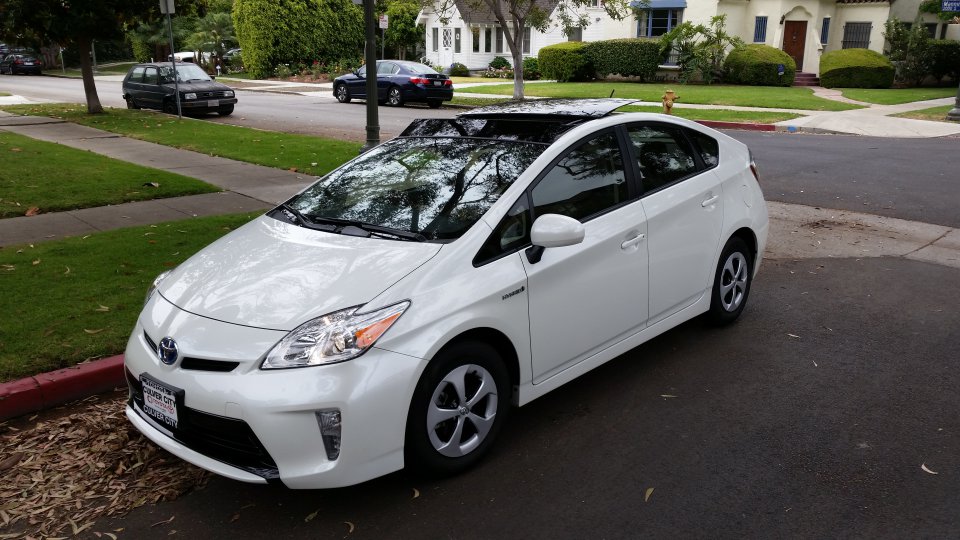

    I'll have it check tomorrow or Wednesday from dealer where I bought it, I'll update this as I have more info
    Here is another photo of my car :)
