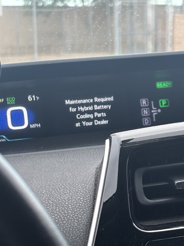

    Hey I’ve got this warning message on my 2016 Prius and when I try to unscrew it it just keeps spinning. I’ve tried no pressure as I unscrew it and using a flat head underneath as I use a Phillips to unscrew, but both methods won’t work. I have a shop that’ll fix it and clean my fan for $250 but I’d rather try to open it and replace the filter before spending that money. Any tips?

    Don't know what panel your trying to remove.
    On mine; you just peel back the rear door weather strip and pop the filter retainers out. You should've been doing that every oil change.
    That might just be a maintenance scheduled warning that you can clear through the maintenance reset procedure.

    2021 Prius
    There is a trick to it. Use a Phillips of course, and engage the tool lightly into that plastic screw and turn lefty-loosy trying not to press and the screw should back out. It's a captive screw, so unscrew until obviously loose and extract the panel.
