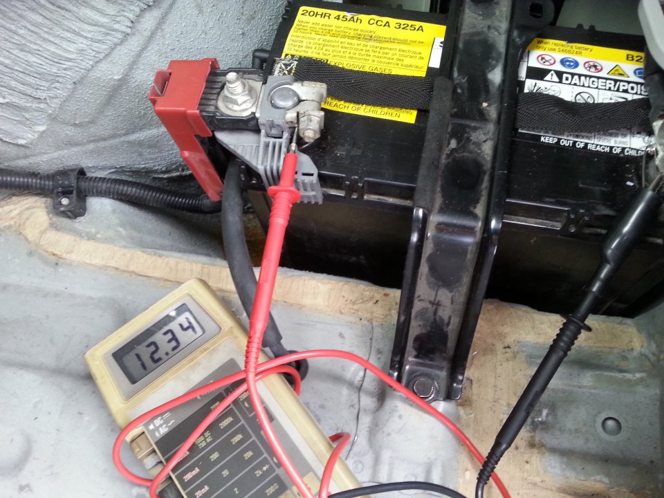

    Once I got my hands on a voltmeter I was shocked to find my battery was below 11v.
    Daaa... no wonder the car was so fussy to get the Ready light.

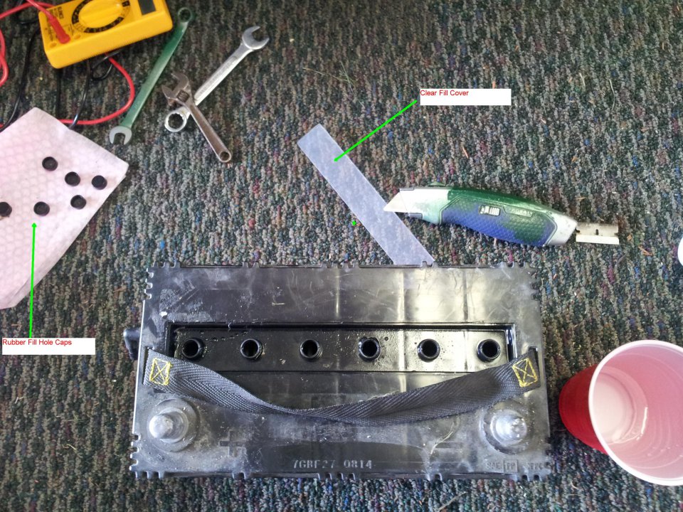

    Attached is a picture of the standard battery with the fill holes exposed.
    As I recall the steps are as follows:
    A. Using a 10mm wrench, remove the battery from the car.
    * Loosen and remove the negative and positive battery posts from the battery.
    * Remove the top metal battery bracket.
    * Unplug the battery vent tube.
    * Lift the battery out of the trunk with the attached battery carrier.
    B. Remove the top stickers to expose the clear battery cover.
    This clear cover is glued in... I used a razor blade and cut it out along the edges.
    Later I just poped it back in and put the stickers back on... but you can also use superglue or other selant on the clear battery cover.
    C. Remove the 6 rubber caps that cover each cell.
    Next shine a light in each hold to check the water level. In my case the water was too lower and plates were exposed.. I added water, charged the battery and all was well.
    If you've been fortunate and had the same batter for the past x years you may find that this simple
    "water check" maintenance will extend the life of the battery and keep you going even longer.

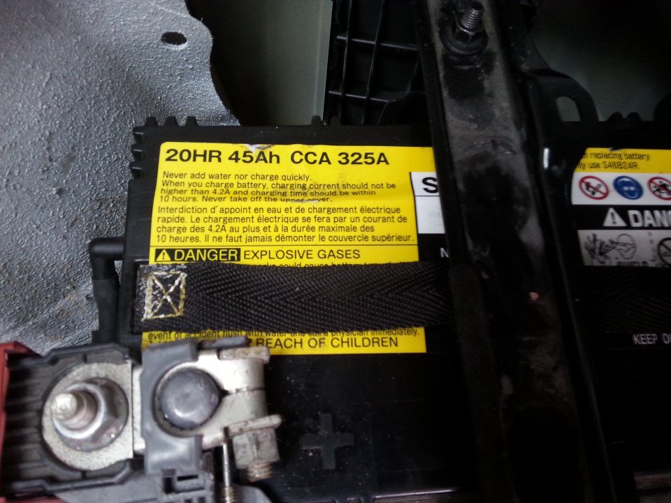

    And now you have an unsealed battery which will spew out acid fumes if it gets overcharged again.
    NOT a good situation.
    If you have a sealed battery and it loses "fluid" there is a reason and that is an indication that something is wrong.
    Simply adding water is ***NOT*** the cure........despite your experience.
    Your battery won't last long probably and the next time your remove it you might be amazed to see all the corrosion that has happened in the battery pan.
    Overall.....VERY bad advice.

    Most sealed batteries on the market today are AGM type, which function similar to GEL cells, and they do NOT lose water over time.
    Unless you absolutely know which type you have, just saying "open it up; break the seal" is bad advice; VERY BAD.
    Now,........if y'all want to revise your advice so that it applies only to semi-sealed, conventional wet cell types of batteries, then I will stop complaining about your posts.

    Adding water to this battery is a piece of cake.
    If you knew anything about the battery you would have to acknowledge some facts.​
    d.) Your comment "Didn't he say that he had to dig out glue/sealant to get the cells open ??"
    No I didn't say that... you misrepresented the facts on that too.
    The conversation was about viewing the cells though the small holes once the top is removed.
    Removing the 6 rubber caps and viewing the level is in fact analogous to removing 6 screws and viewing the fluid levels in a typical motorcycle battery.​
    e.) Your comment "Things that come sealed are meant to STAY SEALED."
    I know "Sealed" batteries are not suppose to leak or lose water under manufacture's recommended situations... but this is the real world and batteries get stressed in various situations. The Titanic was never suppose to sink either...
    If you want to hide your head in the sand and ignore the fact that the battery does lose water and can easily and safely be repaired by adding water and resealing... that's your opinion. Please just note that this is your opinion and stop telling everyone you disagree with you that they have "BAD advice" (especially when you cannot site a single reference for your claims), Making claims that you can't back up is confusing and is a waste of everyone else's time.
    Your solution is ignore the fact that the fluid is low and toss the battery and spend $$$ to replace it... mine is to troubleshoot and solve problems. I didn't post a theory with "made up" conclusions. I posted a real world example from two different Gen3 cars. Both had low fluid levels and both were enhanced by simply adding water.
    This is a common sense solution to real world problem. This is not the rocket science you are trying to make it into... my battery was dead, I troubleshot the problem. I confirmed it was not the car (if we had time to sit and have a beer, I'm confident I could teach you many things is this area but right now just trust me... the battery was the problem).
    I know "you" believe a "sealed" battery means it's never to be opened and can't be done without breaking and destroying it... but the facts are... this battery (The standard Prius battery)... is easy to access and easy top off with distilled water. I did so and the results are now 9 months down the road. The battery has started the car just like a new one from July through May without exception.​
    Enclosed is a picture of the battery... Its not broken or damaged. It looks just as it did before the maintenance.
    The only difference... its no longer dead... its was revived by added water and still going strong.
