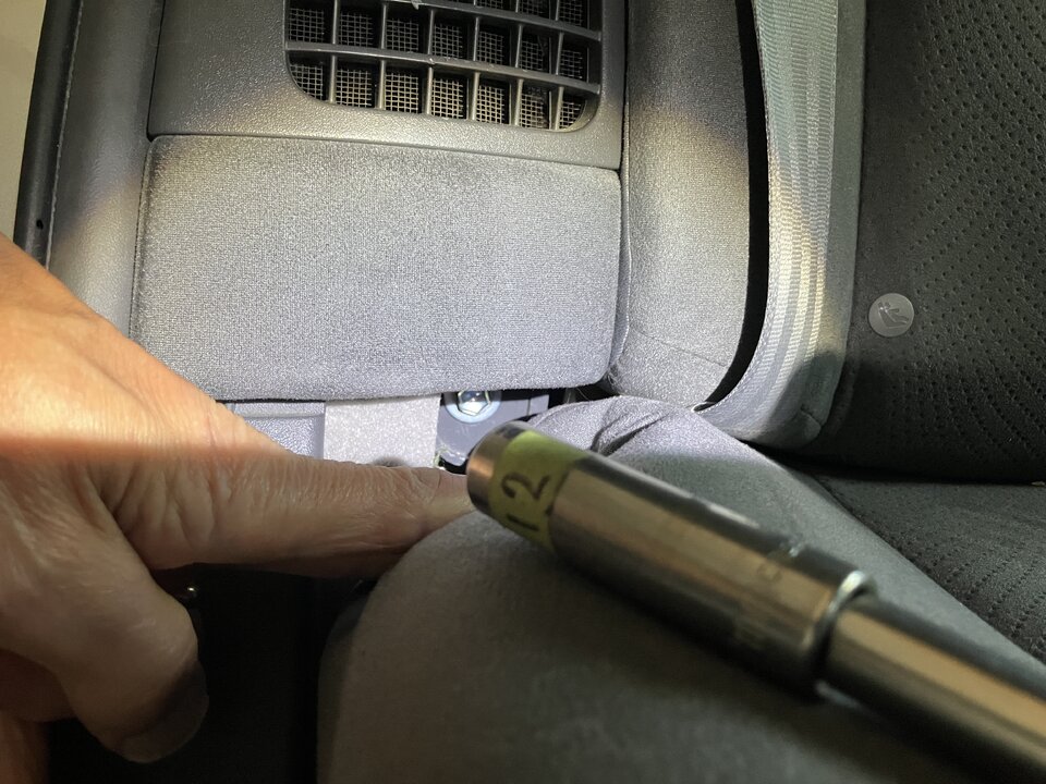

    One comment on the video: he pops up the rear seat cushion, as far as I can see to access one bolt, located just below the bybrid battery fan inlet grill. This bolt fairly easily reachable without removing that seat cushion, with say a 6" extension, reaching through between the rear seat and back cushions. IIRC it's 12 mm socket size.
