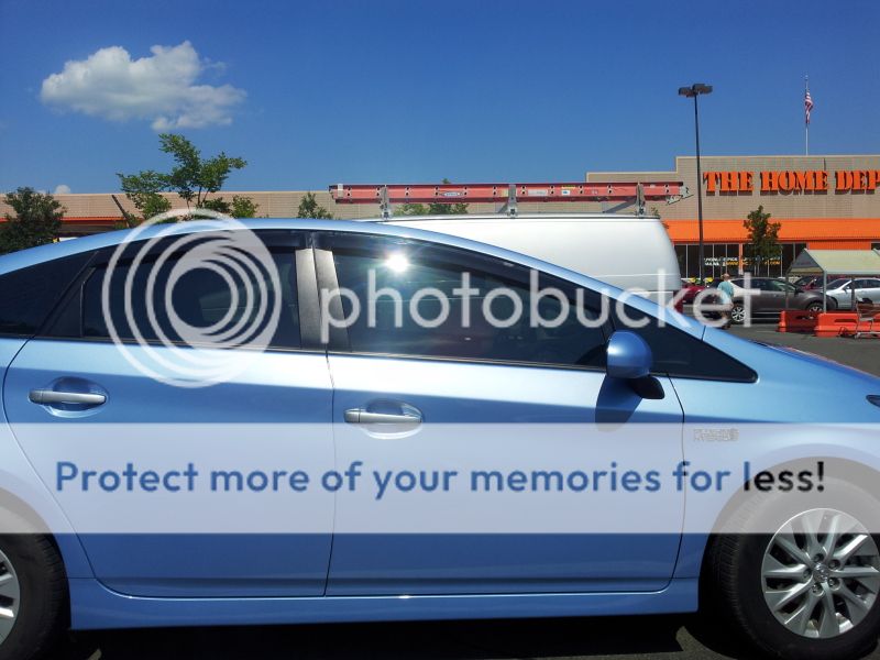

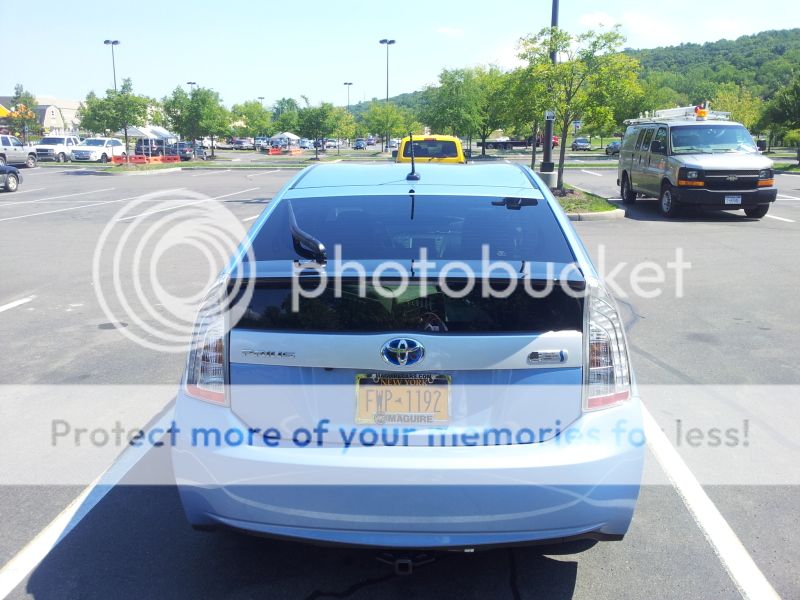

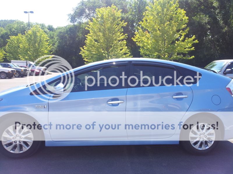

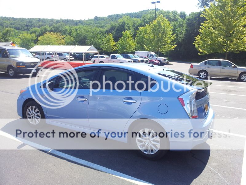

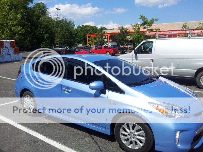

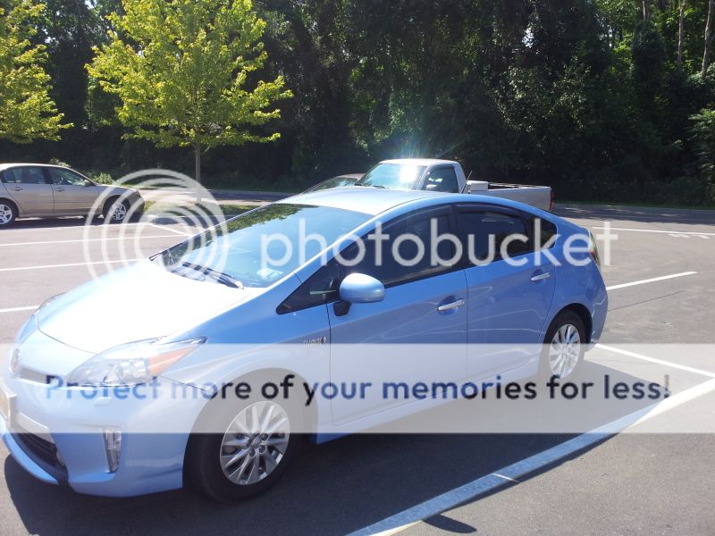

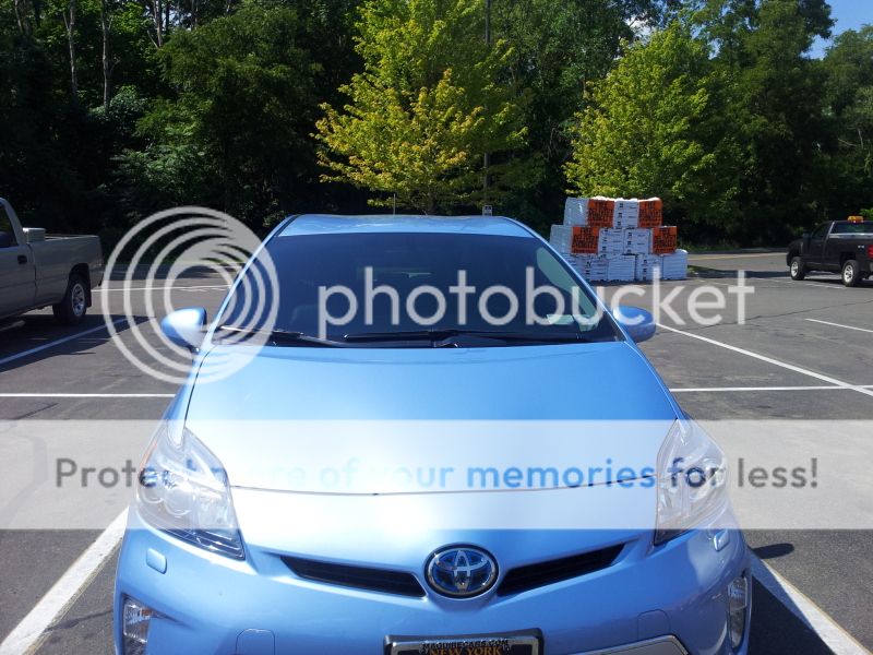

    Here is my tint job. Looks good at least...
    Witness likes this.
  10. 2k1Toaster
    Feb 14, 2010
    5,988
    3,790
    Rocky Mountains
    Looks really good!
