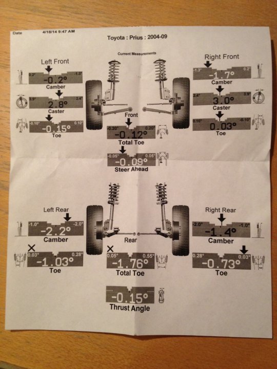

    I am also having problems with a bent axle, causing severe tire wear on the inside of my tires. I was told that I needed to replace the axle beam as it is bent and not repairable. The auto mechanic where I went gave me the following spec sheet on the alignment. Can you Patrick please take a look at it and let me know your thought on how bad my alignment is and if shims are an option? I've attached the spec sheet to this post.
    Thanks in advance,
