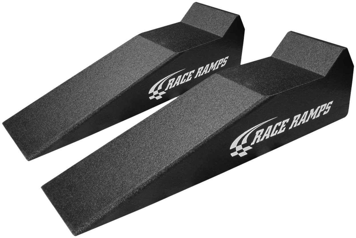

    I'm considering those 40 inch Race low profile ramps on Amazon here [​IMG]
    Would these be fine?
    Georgina Rudkus likes this.

    As long as they get you high enough off the ground for what ever service you intend to perform (oil change?) they would be a good option.
