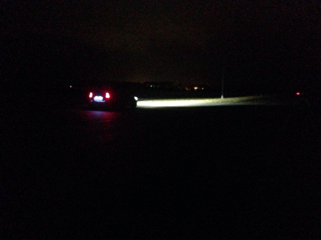

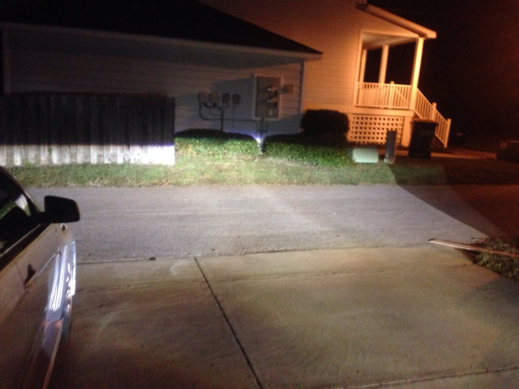

    HID retro fit kit. I got mine in this weekend. Absolutely way better than the stocks. Better than HIDs in the stock halogen projectors because of the "squirrel finders"
    [​IMG][​IMG]
    Fairly sharp cut off, even lighting across the deck. Glad did it. Unfortunately, you have to do the labor. I've done retro fits before and this was by far the easiest. No trimming or anything.
    Plus you have Bi-Xenon projector, so the hi-beams are a little bit brighter than the stock hi-beams.
