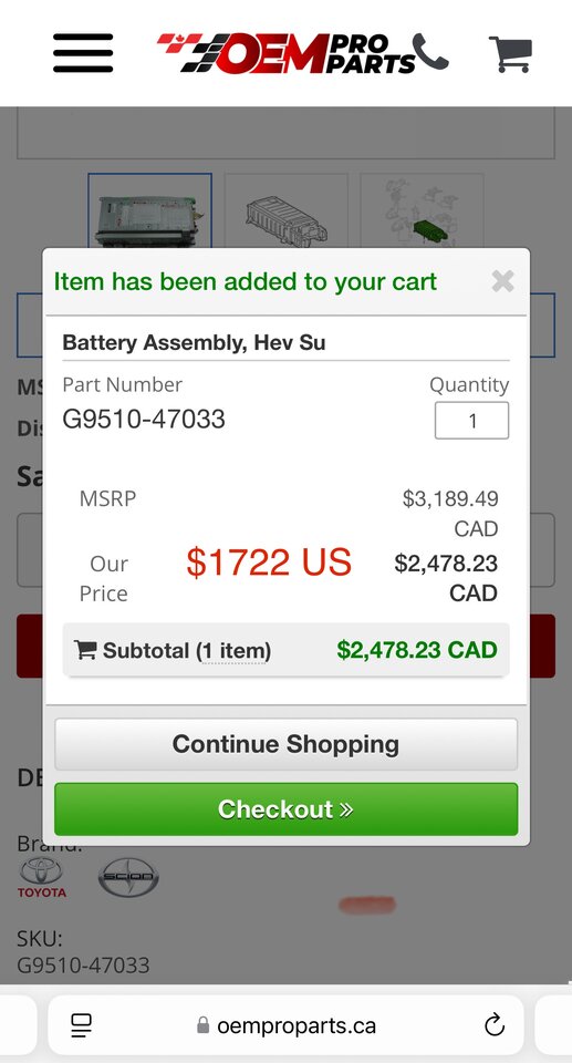

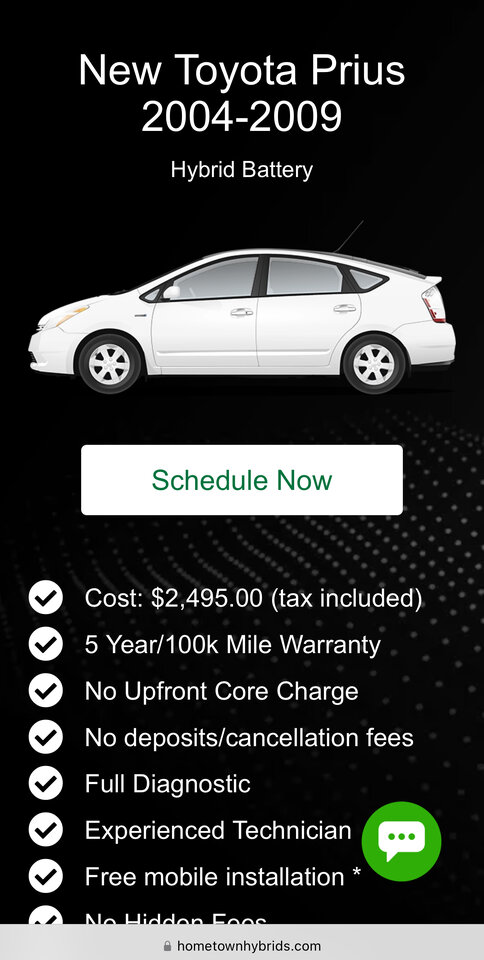

    You don't call the dealers. They will treat you like a walk in customer which means no discount. You find the proper part number and google that number. From the results you pick a Toyota online dealer. I just searched for G9510-76013 for my 2012 v and came up with $1956 at one dealer and many under $2200. These assemblies require you to move your battery ecu, contactors and fan.
    Independents like Hometown Hybrids will turnkey install for $2695. I used them years ago on the v. They sent a guy three hours away with a complete assy, ecus and all and changed it in 30 minutes. Their gen2 oem battery is less and they will ship if needed.
    MAX2 likes this.

  18. rjparker
    rjparker Tu Humilde Sirviente
    Jun 6, 2008
    9,485
    5,808
    Texas Hill Country
    The reality is Toyota sells to the dealers around 50% msrp. The online dealers discount at varying rates but I have seen 35% on occasion plus Toyota Corp has nationwide parts sales that add.
    As a good example a dealer in Canada is selling one for $1722 US.
    I also see $2805 but Hometown Hybrids is less.
    pmelc1 likes this.
