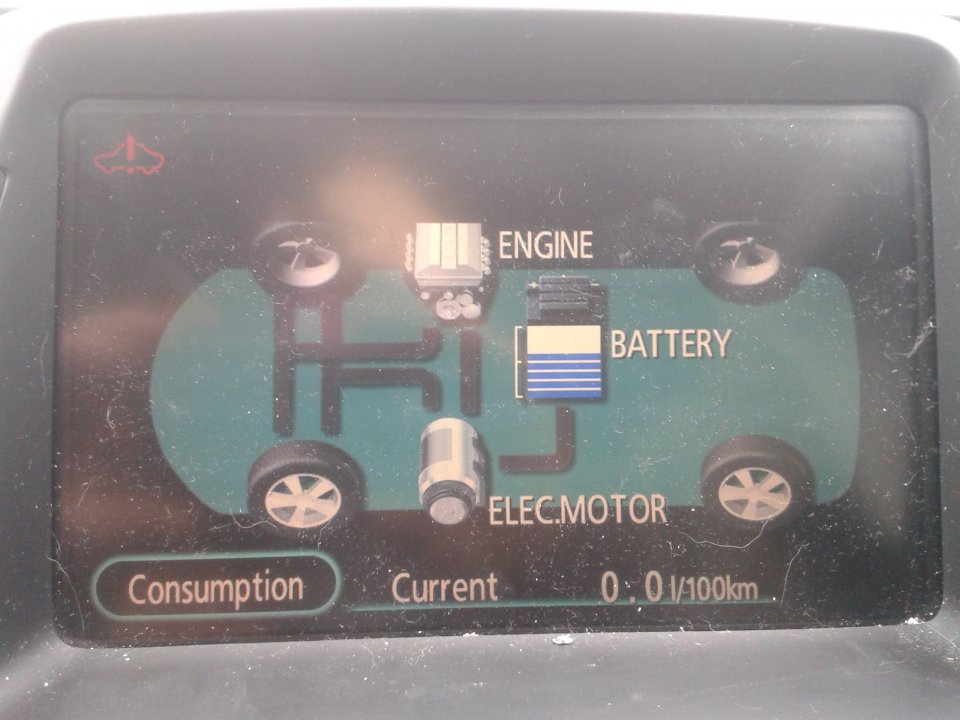

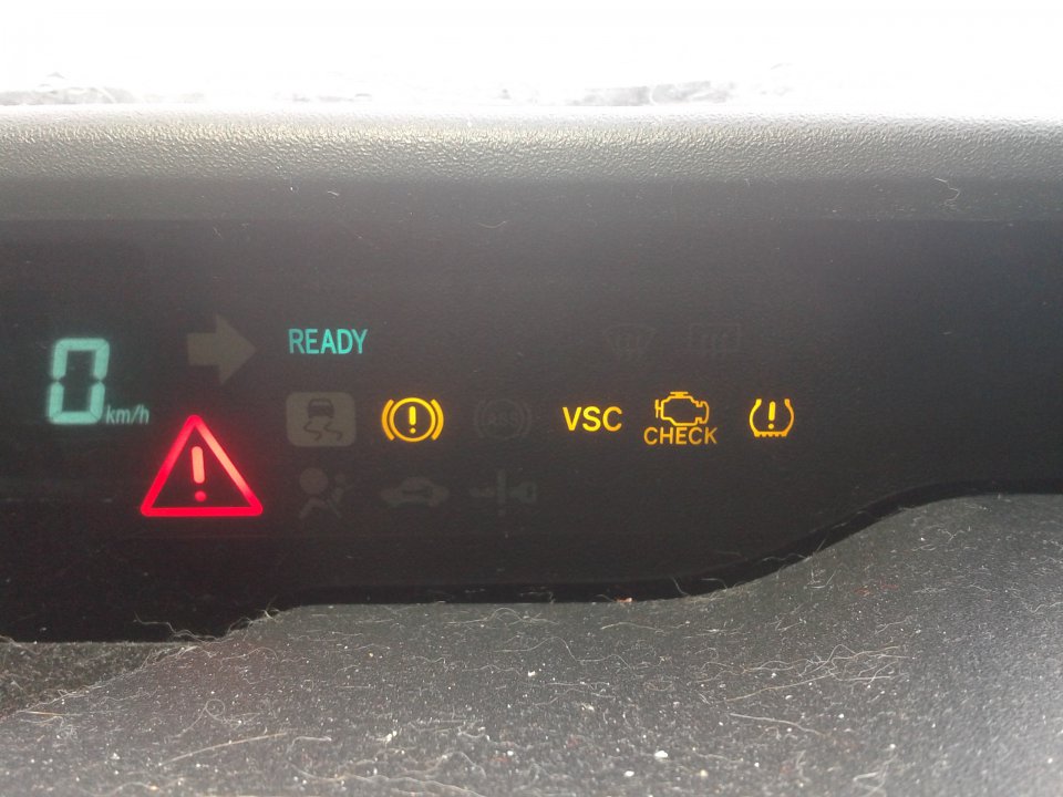

    Hi John, Yea Sears is no longer doing automotive repairs in Ontario. My uncle used to be a mechanic for Sears up untill they closed up the shop. Anyway I was actually out at the car today and fired it up and it seems the inverter is still doing it's job thank the holy banana. Ha ha ha but I did some listening under the hood after the ICE shut down and there is a high pitch noise along with the sound of an older computer hard drive looking for data lol. To me it sounds like it is coming from the throttle position solenoid. Obviously a regular odb reader would pick that up if it were the problem correct or am I wrong? If I am that is cool. Anyways John do you know anything about these Toyota Techstream readers that run for about $15.00-$40.00? Or is that the VCI that you are mentioning? If so then maybe I will just have to bite the bullet and but the Techstream. But I think I am about ready to bang head of the sidewalk lol no not really more like pull my hair out. Anyway I am sure it's a bad sensor some where that is making all the lights freak out. Here is a pic of the warning lights I have currently and if your going to ask if I changed the 12 volt battery I am going to tell you that yes I did and it did nothing to fix my problem so I returned the battery. The car has been sitting all winter so it's a bit dirty. Now as you can see I have the screen set to the charge on the hybrid battery and that battery according to this screen is still charging fine. It does not stay in the blue for very long maybe a couple of minutes. 2006_Prius_1[2].jpg 2006_Prius_2[2].jpg
