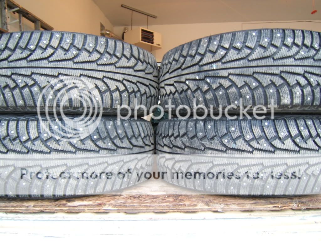

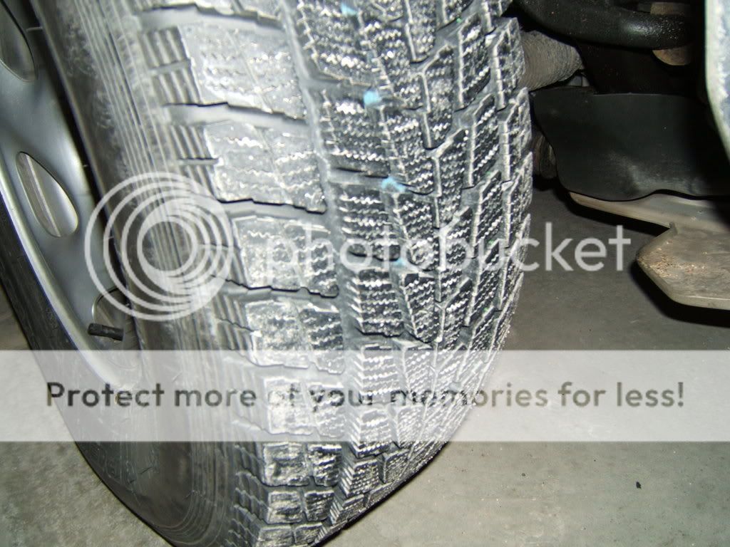

    Well, some Prius owners will claim that their car will charge up icy driveways drifted over with 2 ft of snow, on bald summer tires. Some of us have had Prius cars with Traction Control so sensitive the car refuses to budge in 2 inches of snow.
    YMMV
    After trying a variety of studless winter tires on my 2004 Prius (Dunlop Graspic DS-2, and Yokohama Ice Guard 10) I got sick and tired of the lack of glare ice traction, and went back to a studded tire
    I got the Goodyear Nordic from Canadian Tire. This is actually the same as the Goodyear Ultra Grip 500 sold in the EU
    Goodyear Eur-Winter Tire-UltraGrip 500
    If you click on "Profile" a Flash movie loads that explains the tire construction and testing results. These tires had a hum at 50-65 km/h on dry roads, especially cement roads. On snow and ice they were silent, so who cares.
    It was fun waiting for the light to turn green with icy roads. The guy next to me in a 4x4, his jaw would drop when my Prius shot ahead, with him still sitting there spinning away
    The Goodyear Nordic/Ultra Grip 500 is a highly directional tire. During Spring melt, with standing water hiding dangerous ice beneath, no problems whatsoever. Cars following me would spin out, I had secure traction
    I had my winter tires mounted on multi-fit steel wheels that I got from Canadian Tire. If they pour salt on the roads in winter, you want a steel wheel, no sense ruining the nice aluminum wheels
    Note: if you do decide to run aftermarket steel wheels for winter, you MUST get the correct "acorn" style lugnut for the wheels. Do not use the Toyota lugnut which is meant for their aluminum wheels, as it will dangerously loosen up
    The proper lugnut is easy enough to find. They are M12-1.5 x 21mm thread. The NAPA part number is 10#641-2042, you can usually get them for $1 each
    I finally had enough of dealing with studless winter tires on my FJ Cruiser too. For that vehicle, I had Toyo Open Country G-02 Plus, and on ice my Prius with studded tires had a distinct traction advantage
    I tried to order factory studded Nokian Hakkapeliitta 5 Sport Utility tires for my FJ last winter, but the Quebec winter tire law caught me by surprise, and they had no tires in stock
    This year I ordered the tires in July, even then I didn't get them until mid Sept.
    Nokian winter tires are popular where you live. Have you considered the factory studded Nokian Hakkapeliitta 5?

    Comparing the studless snow tires I ran on both my Prius and my FJ to the studded replacements, I noted NO downside that wouldn't already be present in a snow tire.
    Eg: squirmy dry weather handling, noise, etc
    As far as "ruining" the roads, there are plenty of ruined and grooved roads in NW Ontario due to cheap road construction and overloaded pulp trucks
    The Swedes mandated new stud designs a long time ago. Since they have a mandatory winter tire law, it made sense for them to mandate a new stud design
    The factory-studded Nokian winter tires on my FJ are a good example of that. Each stud has a special cushion under it, which not only enhances traction on ice, it all but eliminates dry road wear
    Nokian Hakkapeliitta 7 SUV
    FAQ
    Some will claim that studded tires contribute to PM increases in winter. The Swedish road research institute, VTI, researched this and determined that salt and sand, left to dry on roads, was responsible for the increase in PM. They also determined that once the roads were dry, street sweeping trucks should be sent to pick up the excess
    VTI - Dust formation propensity of road pavements
    Road wear is all but eliminated with the use of special factory-engineered studs
    VTI - NanoWear
    Again, I have tried both highly rated - and very expensive - studless winter tires, and highly rated studded winter tires, on the '04 Prius and the '07 FJ
    The studs don't even damage the coated floor of my heated garage. The difference in snow and especially ice traction, is immediately evident
    Since I use directional winter tires, the slush and wet traction is also superior
    I would never use any winter tire in warm and hot conditions. The tire will wear out very rapidly
    As far as the studs causing road damage, even Ontario allows studded tires again. For the NW region, and the tires must use the Scandinavian design
