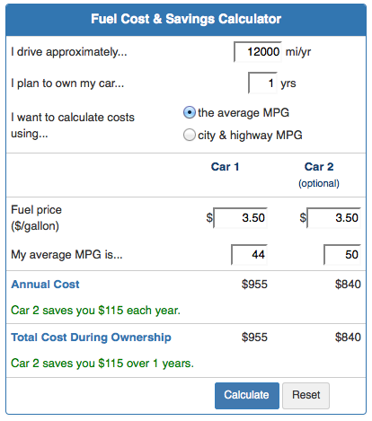

  7. Sporin
    Sporin Prius Noob
    Dec 10, 2010
    576
    293
    Vermont, USA
    I would strongly suggest using a dedicated winter tire for the snowy months. LLR tires, in particular, tend to get very hard below 40 degrees, and none of them come close to the snow and ice traction of a good, winter tire.
    When you are comparing the difference in overall MPG, remember that the cost difference between 44 mpg per tank average, and 50 mpg is very small, even over the course of a year.
    See attachment, or calculate yourself here: Save Money
    If you must just run one tire year round, then I second Roland's recommendation of the Nokian WRG3 Nokian WRG3 - The new Nokian WR All-Weather tires offer a virtuoso combination of safety and carefree driving pleasure for every season. / Nokian Tires
