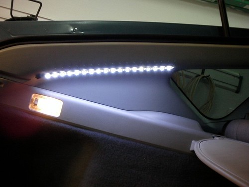

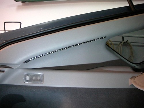

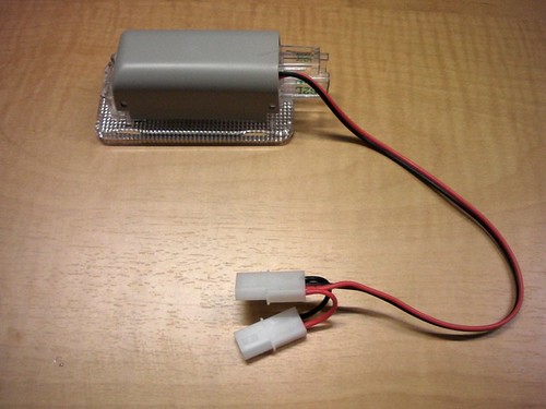

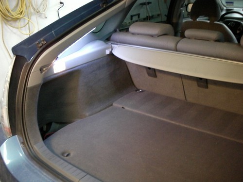

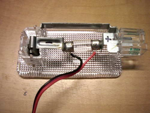

    I got fed up with the wimpy little light bulb in the cargo area. This is especially important to me since I have an Enginer kit back there and if I ever needed to open it up in a dark parking lot or something, I'd never be able to see anything. I can barely see groceries back there. So I bought these two LED strip lights at AutoZone. What I did was pop the little light fixture out and soldered the wires directly to the bulb. I tried to solder to the metal in the fixture, but it proved resistant to soldering. I brought the wire out to two pigtails, one for the left side of the cargo area, one for the right. The lights are flexible and have a very sticky back so I just stuck them to the trim panel and drilled a small hole for the wire. I had experimented for a while to find the optimal position for these lights, and this area seemed to work best. Right now I only have one installed, soon I'll have the second one. I can tell you this, the result is fantastic. The lighting back there is tremendously better and it only cost $19.

    Yes, that is the exact product I used. I don't think it is 24", unless you count both strips. I just finished wiring up the other side and it looks great, I couldn't be happier with the concept.
