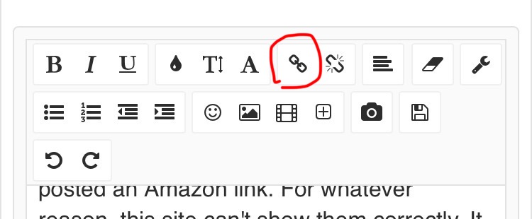

    I’ve found pasting Amazon links into selected text avoid the problem. Also works for links from one site which had gargantuan address strings (name eludes me).
