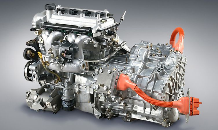

    Hello everyone I am wondering if you can tell me what the black rectangular plate that is on the side of what I believe is the transmission on a 2008 Toyota Prius right above the rear motor mount.
    Thanks

    Pictures always help, but my WAG would be the opening for a starter.
    Does it look like it would align with the flywheel?

    Here is a picture of a Gen 2 Prius Engine/Transaxle, can you point out what you mean?
    From 1:25:35 to about 1:30:35 he shows electrical connections below the rectangle above with the Orange wires near it. (This is a Gen 1, but Gen 2 is similar)

    Little access hole into the bell housing. If you pop it out, you'll just be looking at the flywheel.
    Sort of traditional, I remember similar holes on cars I had years and years ago. If the transmission was an auto, you might need to work through it to reach the torque converter bolts. Not much use for it with a manual.
    Also not much use with a Prius, but reportedly if you've been having misfire rattles for long enough, you can reach in there and down and see if you can scoop out any pieces of the damper springs.
