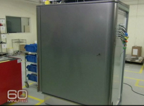

    You put natural gas in, you get electricity out. It's a generator, but quieter and more expensive. If you need a a quiet generator that runs on natural gas and you are willing to pay a lot more than an ICE-powered generator would cost, this is for you.
    How is this earth-shattering???

    I saw the 60 Minutes piece on Sunday and at first thought wow, esp. because of the particular VC involved, then I heard about it being a fuel cell which was a let down. But then, they pointed out the impressive list of customers so far.
    I'm not sure... I wish I had more background in fuel cells. Are their units, for a given output that much cheaper than other fuel cell implementations? How much would a plant not using these cells but running on natural gas cost per unit of output?

    What would bother me is the fact that the operating temperature is 1000 degrees C. At that temperature steel glows lemon yellow! So unless the elements of the box that operate at those temps are strictly localized, the potential for fires is very high.
    OTOH, not knowing the details I'm merely speculating. But the idea does seem interesting.

    Low emissions probably refers to the absence of the products of incomplete combustion, which you get from internal combustion engines.
    Carbon would be the same as from burning the same fuel. So there would be less carbon than from coal, since coal is mostly carbon, whereas natural gas has a lower percentage of carbon.
    Also, coal has nasty heavy metals, which natural gas does not, so it's lower emissions than coal plants on that grounds as well.
    I presume that when they say "wireless" what they really mean is that if you have neighborhood power generation you don't need those big cross-country power line wires. You still need wires from the generator to the end user. There is no practical means of transmitting electricity wirelessly. And you need a means of getting the fuel to the generator, so you'll replace the transmission wires with pipelines.
    A fuel cell cannot run on sunlight. However you can use a PV array to produce H2 via electricity, and store the H2 to run the fuel cell at night. Inefficient, but possible.
