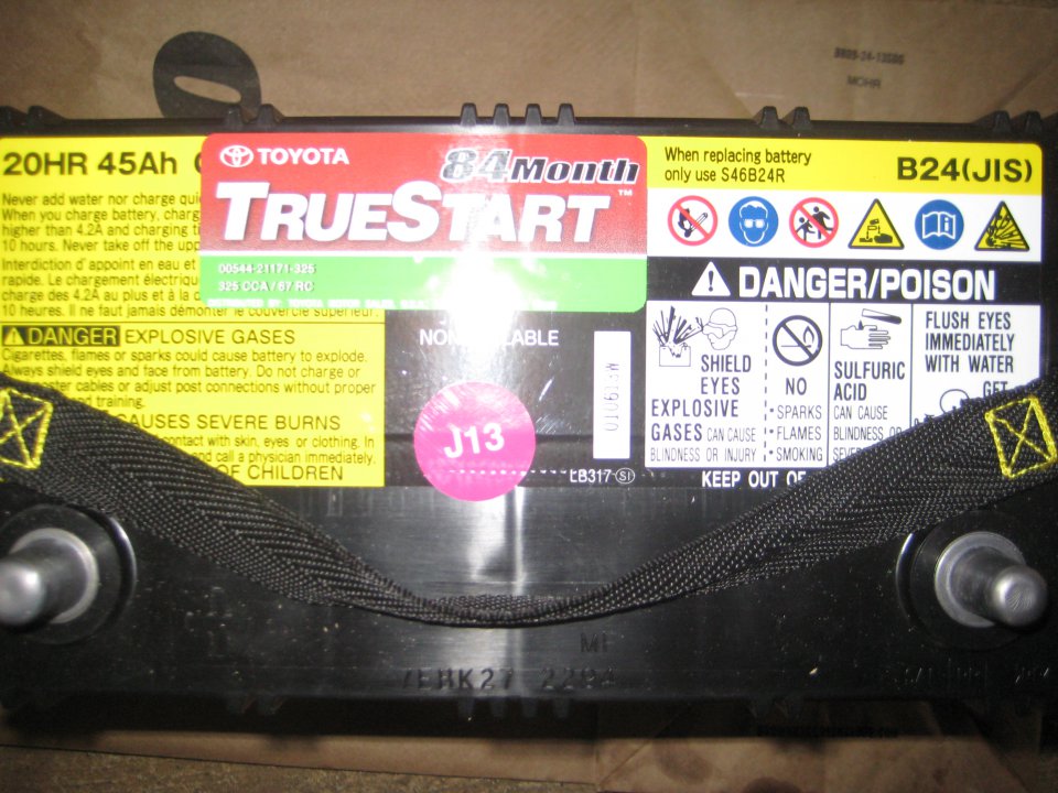

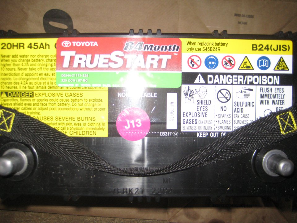

    The little 12 volt will probably last about four years. Little to no warning will be given before it fails. Except for funny things to start happening with the Prius. When you need a new battery, make sure you use the correct one. I recommend the OEM battery. Other's will recommend different brands. The main thing is to get a AGM type battery that fits properly, vents properly, and has the reversed JIS posts.
