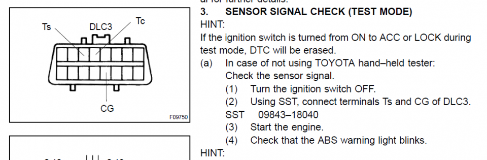

    If you don't have a scanner, you can use a thin electrical wire to connect the Ts and CG terminals on the DLC3 (ODB II connector) and read the trouble code. You will also need the factory service manual (FSM) before you can proceed. Again, this is not something I would recommend attempting without the FSM or Prius aware scanner that can bleed the brake properly. Also, be prepare to give yourself plenty of time for the repair. You need to get the codes, find out if it's the booster pump, learn how to take it apart, put it back in, bleed the system and hope that you got the right fault part. The booster pump seems like a high failure item for first gen Prius, I just hope the prices don't go up for the pump as first gen Prius become more rare.
    This is a diagram from the FSM showing you how to short the Ts and CG terminals. But you need more than just this diagram, you need to read and understand how to replace the booster pump.

    My notes have that you get the trouble codes out by connecting Tc to CG. (Tc is also shown in that diagram.) Ts to CG is used for other purposes, like testing the wheel sensor signals.
    Tc to CG is the basic magic jumper trick that makes all the ECUs (except battery and HV) blink out their troubles on the dash.
    -Chap

    you are right, I went back and double checked, it was Tc to CG, not Ts to CG as my original post. But no harm done if you connect Ts to CG first, you just wouldn't get the codes. :)

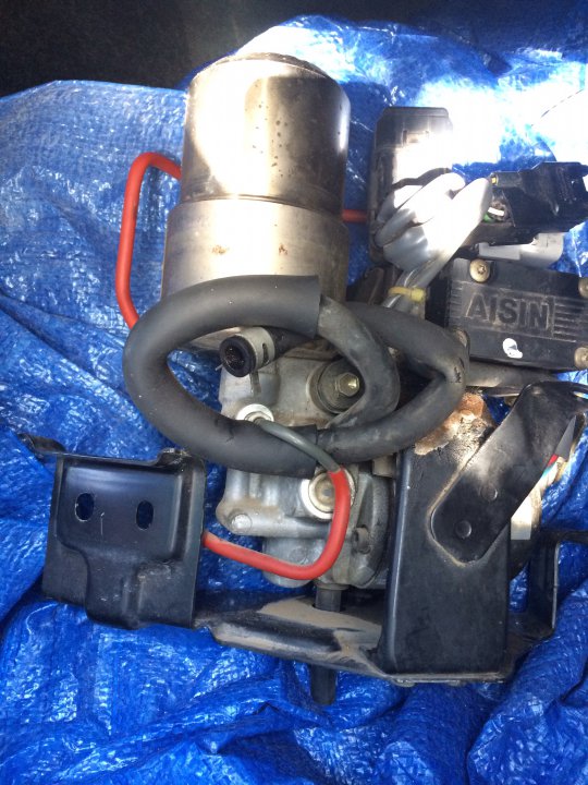

    Hi guys, here's an update. I took it to a hybrid repair place and they gave me this. The alarm went off for a few minutes and my brakes went back to normal. Unfortunately, the alarm came back on and my brakes soon went back to stiff and hard once I restarted the engine. I just bought the part off of craigslist used. No warranty. Now I'm afraid if the part doesn't work, I will still have to pay $560 for the labor. Is it worth the risk or should I just sell it off. Is $100 per hour fair for labor?

    You have to make that decision yourself. It sounds like you either have a small leak or the pump/accumulator is failing causing brake pressure to be lost. With a used pump/accumulator that you bought, you are taking a gamble. So the question is whether $560 is worth it to gamble fixing your brake. The labor is actually reasonable in my opinion because it took me way longer than 5.2 hours to replace the pump/accumulator. But if the shop has done it before with success, there's no reason why they can't finish it faster. Have you approached them about installing a used pump as some shops won't install used parts?

    Yeah it's a gamble. I've decided to go through with it. I got the part taken off a collision car. The mechanic is willing to install my used part but he did make it clear that regardless of whether or not the used part works, I still have to pay the labor. I got the part for 110. I actually didn't need the whole thing, but it's only sold that way from the dealer. And he said it's better to buy the whole piece as there would be a higher chance of it not working if bought seperately. I'm bringing the car in on Tuesday, I have my fingers crossed
