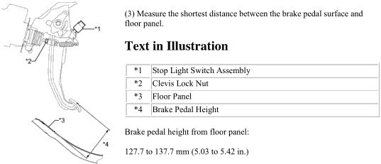

    There is a button above the brake pedal that controls the brake lights. When the pedal is released it comes all the way up and pushes the button, and the brake lights are off. When you brake, the pedal moves down away from the button and the lights are on.
    If the released pedal isn't coming up high enough to push the button and turn the lights off, something needs to be adjusted. I'll mention the adjustments in reverse order of likelihood (you'll see why).
    1. (last resort) The button itself is adjustable if needed. You never touched it, so it shouldn't be needed, so only touch this if the steps below haven't fixed the problem.
    2. The brake pedal height when released is adjustable, using the clevis on the cylinder pushrod. The pedal height should be adjusted to the measurement in the drawing below. But only touch this clevis if the step below hasn't fixed the problem.
    3. (First thing to do) Recheck how you mounted the new unit to the firewall. Make sure it is not cockeyed, nothing is stuck in between, holding it away from the firewall. If it came with a gasket to go between the unit and the firewall, make sure the old gasket isn't still stuck on the firewall too.
    Only if you are absolutely sure that the unit is mounted flat down on the firewall where it belongs, then measure the released pedal height as shown in this drawing, and if it isn't right, make it right as described in this post.
    Note the measurement is from the bare metal floor, so the carpet has to be folded back.
    Only if you have measured the pedal height and you're sure you've made it correct, and it still isn't pushing the button to turn off the brake lights (this is darned unlikely), then you would adjust the button itself.
