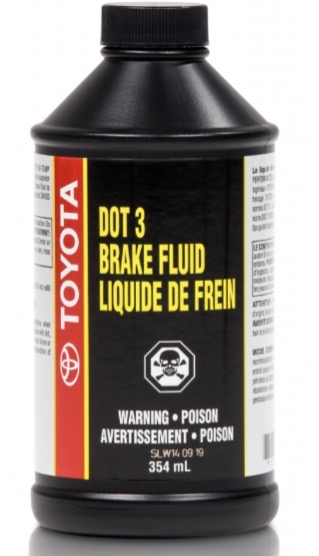

    Toyota Canada policy now is to change it tri-yearly or 48K kms (30K miles), whichever comes first. I pay no attention to the color, just drain and replace two pints (one quart) tri-yearly. DIY it cost about $15 for the fluid.

    Regarding volume of fluid to be replaced: it would be REALLY nice if Toyota would publish this info. I've gone with 2 pints (1 quart), but I did just hazard a guess. IIRC dealership did 4 pints (invoice says "4 units", when they did a change one time, during a brake recall campaign).
    2 pints seems pretty good to me, allows an initial baste-and-fill of reservoir, and a goodly amount bled out at each corner (more at rears than fronts) and an ounce or two held in reserve, in case you want to fine tune the level in the next day or two (I've never needed too though).
