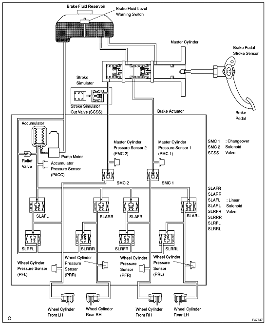

    My topic concerns the brake master cylinder pressure sensors on the 2008 Prius.
    I don't want to go into why I need the information I'm asking about. Suffice to say that I want to tap the signals coming from these sensors.
    As far as I can ascertain from my reading, the pressure sensor (there are two on the output lines of the master cylinder) sends voltage information back to the skid ecu, and along with the sensors on the brake pedal, a determination is made by the skid ecu as to how much fluid pressure is required to meet the demand (am I right so far).
    I have scoured the schematics (both from Toyota site and Bentley Publishers manual) for the brake system but am unable to find any symbols or wiring for these two sensors sensors.
    What I have found is an electrical connection for pressure sensors (4, they area PFR,PRL, PFL and PRR...) between the skid ecu and the ABS,BA,TRAC and VSC actuator. These four acronyms are of course the pressure sensors at each wheel brake (I'm pretty certain these are not the ones mentioned)
    My question(s) are:
    1.Is my assertion above correct?
    2. Are there in fact electrical signals coming from pressure sensors located on the brake master cylinder output lines,to the skid ecu?
    3. Where can I find the schematic for this wiring?
    4. Any further information available that will assist me?
    Thanks everyone, and any help will be greatly appreciated
    regards
    Ray

    The Prius is a dual-circuit braking system. It's basically 'brake-by-wire' except that hydraulic fluid and pressure sensors are used to provide the input, rather than electrical position sensors as in the 'drive-by-wire' accelerator.
    In normal use, the hydraulic lines from the master brake cylinder go only to a 'stroke simulator' - a piston that permits the brake pedal to move and provides braking feel. The master cylinder pressure sensors, PMC1 and PMC2, measure the driver's braking pressure. SMC1 and SMC2 are closed, so for the moment ignore the lines leading from there to the wheel cylinders.
    The Skid Control ECU takes those sensor values and computes how much braking force to apply to each wheel. It asks the HV ECU to provide as much of the braking force to the front wheels as possible through regeneration, and the HV ECU reports back how much it achieved (this is done via CAN). The Skid Control ECU then distributes the remaining braking force required across the friction brakes, turning on the SLAxx solenoid valve for each wheel to Apply the brake further (increase pressure) and the SLRxx valve to Release the brake (decrease pressure). For example, SLAFL and SLRFL control the Front Left wheel and SLARR and SLRRR control the Rear Right. It monitors the pressure achieved with each wheel's Pxx sensor (PFL, PFR, PRL, PRR).
    Pressure changes are achieved by having a chamber (accumulator) that stores fluid at high pressure. When an Apply valve is opened, the high pressure fluid flows to the lower-pressure wheel cylinder, applying the brake. The Accumulator Pressure Sensor (PACC) measures the pressure in the cylinder so the ECU can decide when to run the pump motor, to keep the accumulator pressurised.
    The reason that hydraulics are used in the sensing side is so that in fail-safe conditions, the master cylinder is connected to some wheel cylinders, operating them directly from pedal force. This is where the Skid Control ECU cannot operate the brakes for some reason. Two valves that normally stay closed, SMC1 and SMC2, open, and the stroke simulator is closed off (valve SCSS). Instead of moving a piston in the stroke simulator, pedal input now directly controls the front wheel cylinders.
    There is also an electrical brake pedal stroke sensor (a potentiometer), which is used to determine how fast the pedal is being applied. If the ECU detects a fast application it does Brake Assist, where it actually applies more force than the driver's pedal pressure indicates. It's been found that in emergencies, drivers tend to brake sharply but not actually hard enough.
    The fact that the wheel cylinders are completely cut-off from the brake pedal, in normal use, means that the normal air bleeding procedure of opening a bleeder valve and pumping the brakes does not work. Instead you have to use the diagnostic computer to ask the ECU to bleed the brakes.
    Back to the original question, the 'brake pressure indicator' that Bob talks about can be found at http://www.techno-fandom.org/~hobbit/cars/bp/ (which is where I stole the top diagram from). PMC1 is found on pin 30 of Skid Control ECU connector block S7, and PMC2 on pin 27 of block S10. Or, alternatively, PMC1 is pin 38 and PMC2 is pin 43 of the brake actuator. According to Hobbit's description, the sensors are powered by the ECU (VCM1 and VCM2, respectively) and grounded by chassis ground - GND1 and GND2, pins 31 and 32 of the actuator, which are common ground points EF and EE with the 6 ground points of the Skid Control ECU. Common chassis grounding is the norm in vehicle electrics.
