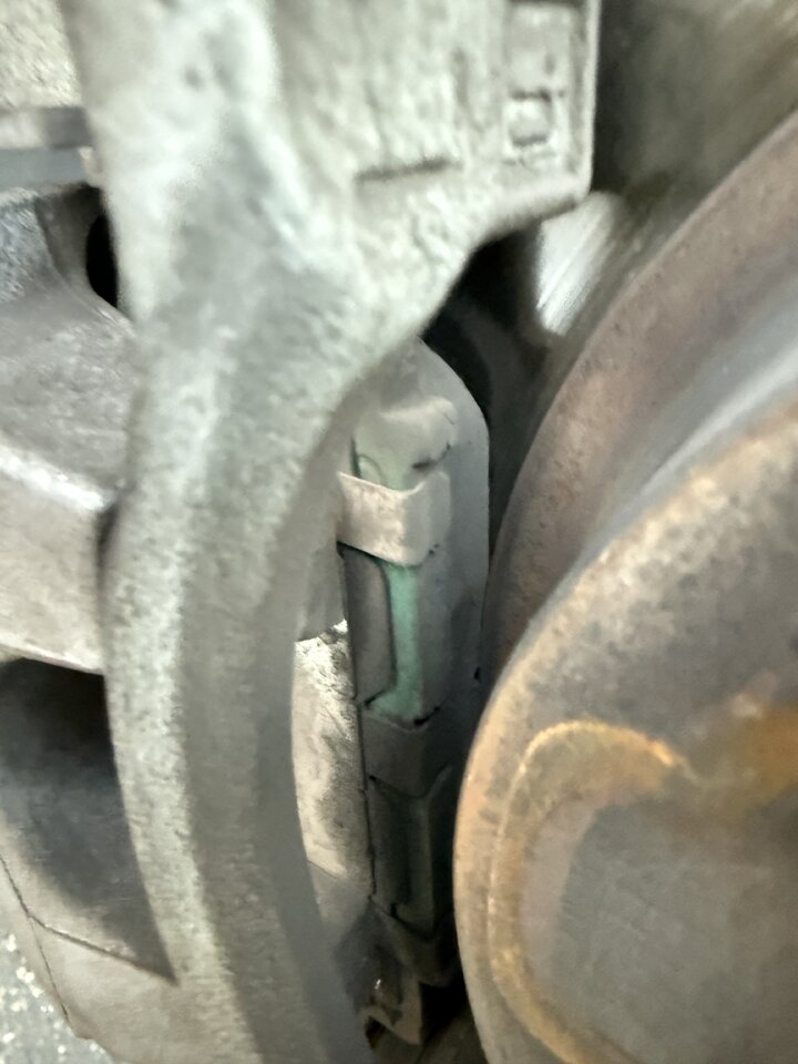

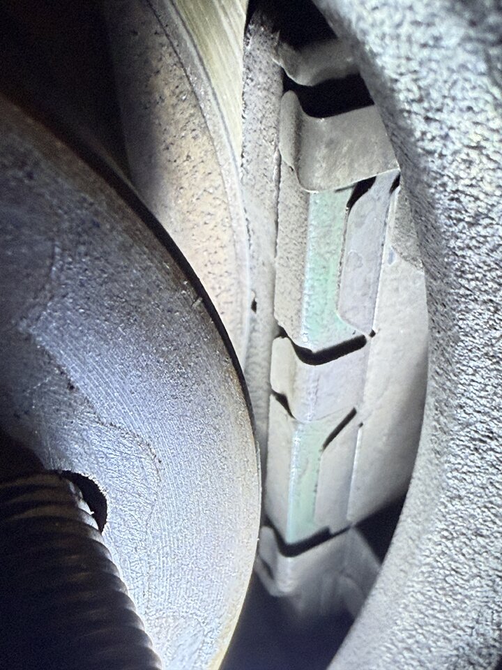

    Can I ask about these brake pads? These are the outside on the drive side and non-drive side respectively. I took a look at the inside pads, and based on a visual inspection, the depth of the groove is about the same on the inside and outside pads.

    They look new....

    Looks like 5-6mm at least to me.

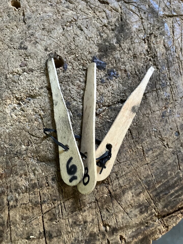

    There's brake pad thickness gauges, you just reach them in there, see which fits. But really, just something like a few popsicle sticks (whittled to various mm widths) will do.
    there’s someone here who just lost his mind last time I mentioned these. Hey, I have dial caliper, feeler gauges, micrometer, dial gauge with mag base. I understand and use those. But brake pad thickness is not machine shop territory lol.

    lol that’s smart. I just use my eyes and if I need to, I use a metal ruler.
