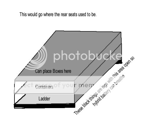

    Well the first step was thinking of is to build or have someone build something like this... basically with the rear seats out, I'd put a platform like in the drawing I made... where the back seats used to be.
    In the bottom shelf, I'd put a gorilla type ladder that folds down short but chubby. In the second shelf would go some containers I could easily slide out to access tools and such. Then boxes sit on top of the entire thing.
    I appreciate folks telling me to get a van, but I don't need to carry that much equipment for what i do, and I feel the Prius v is more than enough to fit everything.
    It's just a matter of being able to access it all without having to take out everything I put back there know what I mean? :)

    looks like some 4 x 8 sheets of 3/4 a/c plywood, and some long drawer slides for the middle shelf. does the battery breathe through the floor?

    I suppose it could just be as simple as that huh? So thick sheets of plywood and some 2x4... but man that would be ugly... then again, it is a work vehicle i suppose. Maybe I can find a way to carpet it or something?
    Yes battery breathes through the floor... specifically states not to cover the vent where it breathes from.

    there must be companies that make the stainless slide out shelves for the transit et al. but you probably looking at some serious denaro. how about the places that do truck racks and stuff? i suppose it would have to be custom sized.

    That's just the air intake. You also need to leave the under-deck compartments in place so it can properly vent through there into the 12v battery area.
