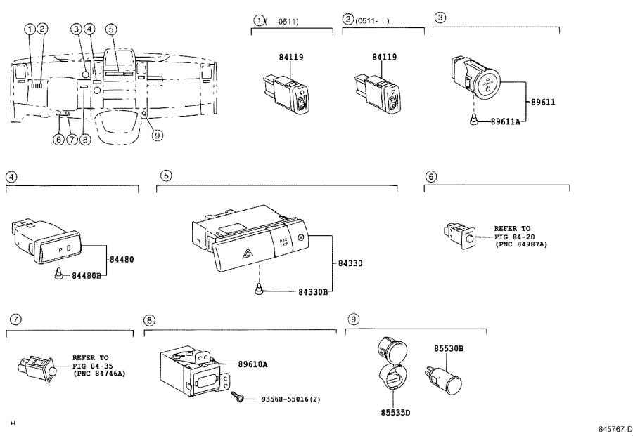

    my interior backlight bulbs for the 2 buttons are burned out and I was wondering if anyone knows offhand what the bulb size is before I go tearing into my car

  3. ChapmanF
    26,488
    17,349
    How old is the car? This is the Gen 2 forum, but the OP's profile says 2010.
    But then, in Gen 3, I think those are LEDs and don't burn out.
    So assuming it's a Gen 2, this is the power button bulb, and this is the park button bulb.
    The last time I replaced those in a Gen 2, I also changed the shift lever backlight, this one (which, for some reason, is sold separately from its little green cap).
    I didn't have any trouble with the panels. A rule of mine is to use only the pads of my fingers, no pry tools.

    Oh this is on my gen 2 2009. I’ve had various prii over the years including a 2012 in the stable
    yes correct some of the plastic is very brittle that’s why I don’t want to take it apart put it back together and take it part again
    on Hondas, they are little tiny bulbs that use flat heads that quarter twist so I figure they are something similar on the Prius

    Yep, that's what they look like.

    Based on your links the part numbers are:
    1. Bulb "a": 90010-01061; and
    2. Bulb "b": 90010-01039.
    I don't remember which bulb is for the park indicator or for the start button indicator.

    Look at the words around the links in post #3 ?

  14. ChapmanF
    26,488
    17,349
    There's a multicolor LED inside the power button for status indication, but its illumination backlight (illuminates the word "POWER") is not that. It's one of those old-skool standard tiny incandescents (in Gen 2) wearing a green cap.

    This is the Gen 2 forum, and in Gen 2, the illumination backlight for the power button is an incandescent bulb ... as covered back in post #3, which linked to its part number.
    It isn't hard to replace. As you see in the picture, it's just in a little twist-out on the bottom of the power button housing.
