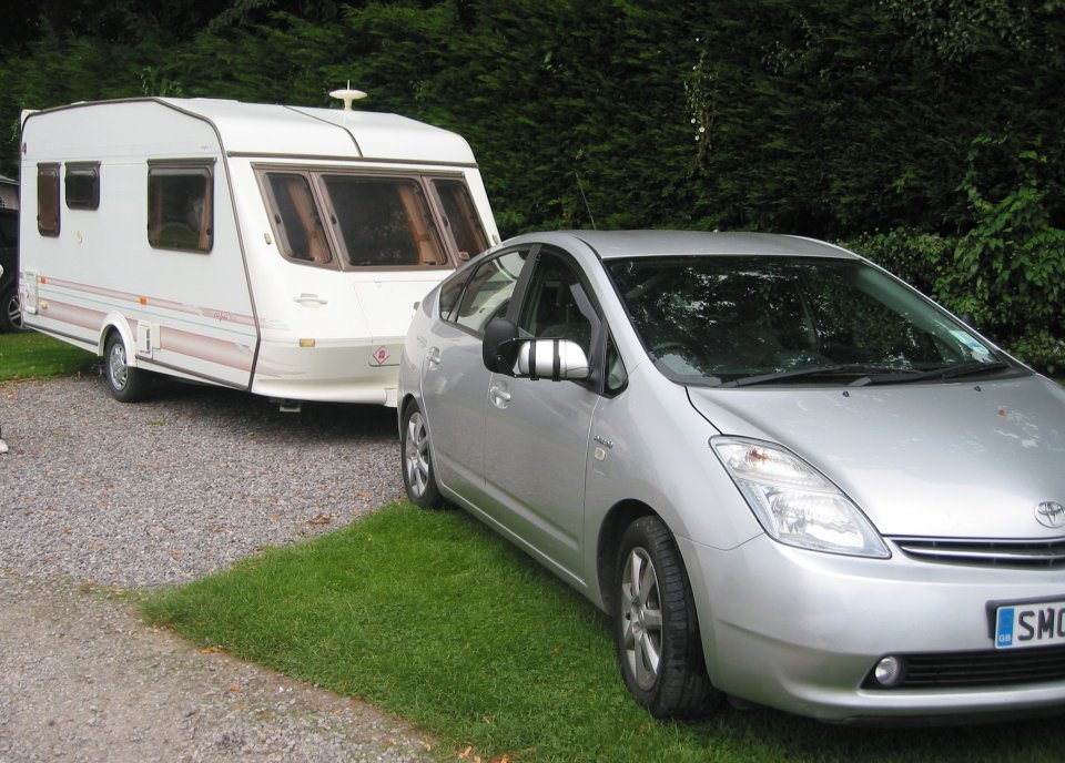

    I already tow a van pictured below, and can monitor the temperatures of the two MG's along with the inverters. The circulation pump is my stumbling block at the moment, but I am considering using an inverter coolant pump to pump the transmission oil. After all if the pump fails the only thing I loose is the extra cooling loop.
    John (Britprius)

    OK! I'm impressed. The G2 Prius must be a lot tougher than I had been thinking.
    What (OBDC device) do you use to monitor temps? I bought one off the Internet, but the CD was full of viruses, so I've never had the chance to use it. Do you know where the Prius Transaxle Temp Sensors are actually located?
    On a side question, do you have all your ECUs running the latest firmware, do you know? Not sure where mine are at, but there are some annoying features. (Mine's an ex-JDM Import, so there are no local records.) For example, the Climate Control - when the Outside Temp is higher than the inside (Climate Set point?) temp at Power On, the system automatically assumes the Air Con is On even when it isn't, and sets the Air Control to Recirculate, which is rather annoying when the Air Con is actually Off.
    Also, sometimes, my Engine Control ECU hiccups. After coming to a stop, it switches the engine Off based on some condition, then a split second later, before it has stopped, turns it back on. I get a jolt in the transmission as it does the Off/On glitch. Then, after a further 10 or 15 seconds running, finally turns it Off properly. Also, occasionally, before the engine has thoroughly warmed up, it turns the engine Off while rolling (maybe while braking?) but the engine stumbles and judders to a stop, resulting in juddering of the whole car, which is quite unnerving and starts to feel like ABS activation (but isn't).
    Do you have any of these issues?
    P.S. Love the extension Wing Mirror!
