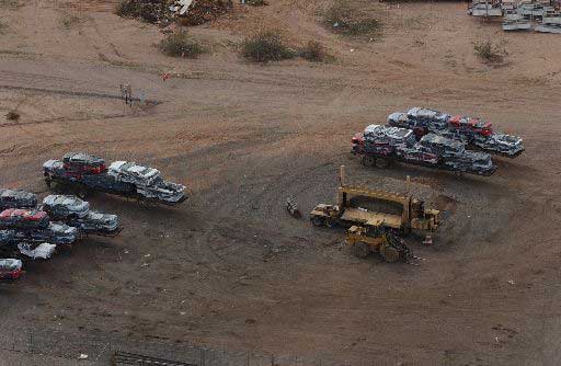

    Oh cool! Where can I buy an EV1 on the used market? ;)

    You could steal one from a museum and transplant the guts from a Chevy Spark EV. Will probably do better than any EV out there now except for Tesla. ;) [That in itself is sad for the state of EV]

    GM did gut the cars and give them to any university that wanted one. Wisconsin students put one back together with Ford Ranger Batteries (also donated) and some donated electronics.
    http://vehicle.slc.engr.wisc.edu/?page_id=241
    People forget pesky things like crash tests. The ev1 could pass the one made for it in its day, but it got 3 out of 5 on the frontal test. I doubt it would even be street legal on today's much harder tests.
