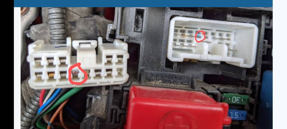

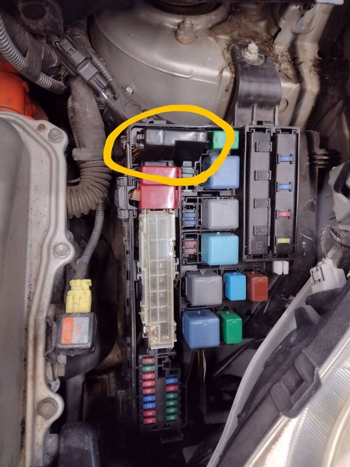

  6. bisco
    112,733
    51,306
    rodents chewing on wires, corrosion on ecu connectors
