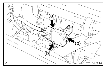

    On the 2004-2009 Prius, here is the MAF peeking out in the bore
    A closer view
    The shop manual detail. a) is the connector, b) are the two small philips head screws

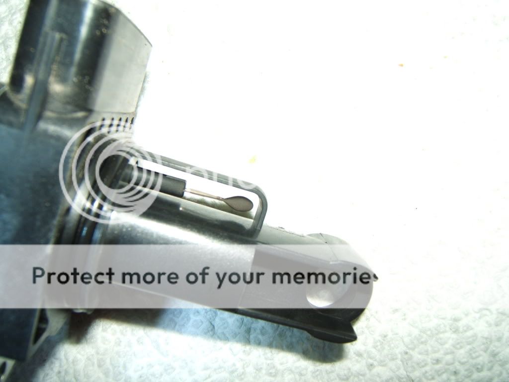

    I've only cleaned the MAF a couple of times on the 2004 Prius I used to have. Honestly could not say if it ran better afterwards. But with the FJ, a very noticeable difference
    Here is the MAF from my FJ before cleaning. The bulb thing is the intake air temp sensor, which is also part of the MAF
    After giving a 2 sec spritz of the proper cleaner.
    The sensor works by means of two "hot wires" inside the barrel. Any deposits of ash and whatnot, impair performance. One must aim the blast of cleaner inside the barrel, and two seconds is PLENTY to clean it
    Here are the two hot wires after cleaning
