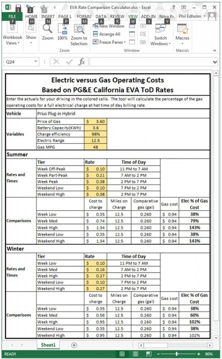

    We just bought a 2014 Prius Hybrid as we realized that the electric cost saving of the PG&E EVA ToD Tiering plan could save us almost the monthly cost of the car. However, the EVA tiering is really expensive during the day. My wife asked if she should plug it in and I had no idea. So I generated a gas to electric cost comparison tool that lets you enter the rate pricing, the price of gas and some other variables and it calculates the compared cost for the first 12.5 miles (that is what we are getting as we live up a hill). The tool is in Excel and the results are shown in the figure. As you can see, in the Peak Tier (2PM to 7PM Summers, 3 PM to 7 PM winters), it is actually 43%more expensive to use electric than gas based on the $0.38 per KWh. For us, my wife uses the car for a round trip early weekdays and this tool shows that it is worthwhile to plug it in if we are going to drive later in the day, but leave it off charge if not.
    Anyway, I loaded the file on my business wen site and you can download it if you want to do it for yourself. The yellow cells are the entry cells. The sheet is locked so it is not easy to screw it up, but there is no password, so if you want to change it, unlock the sheet. This is the URL to download the tool. The forum will not let me put a link in yet, so I am going to fake it out. Here is the link in a jpg, I will re post later when I get permission form the site as a copy-able link.

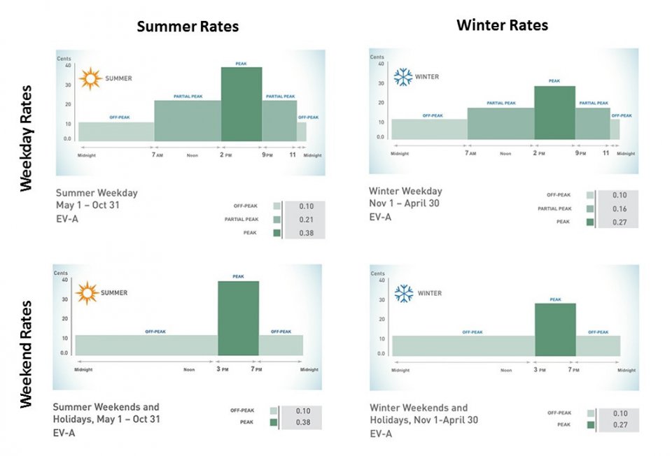

    What is interesting is that nighttime charging is 62% less expensive than gas, wish it had a slightly bigger battery..... Anyway, hope some of you find and this interesting. I also added an image of the rate structures here that I posted for us to remember.

    Phil, that is a really great spreadsheet! I have a couple of nit-type comments. The battery capacity from 20% SOC to 85% SOC is about 2.86 kWh. (4.4 kWh battery total) Charging efficiency considering power from the wall is probably more like 90%. The word "Tier" is normally used in the progressive rate increases based on monthly totals. You might want to use Peak, Partial Peak and Off Peak per the PG&E rates. Many people get better than 48 mpg after the electricity is used up. On long flat freeway trips I get about 53 mpg. For mountain/hilly trips I get closer to 62 mpg due to the great regeneration charging of the PiP.
    Needless to say putting my numbers in the spreadsheet doesn't make much difference. With my solar panels and considering either E-6 (charging mostly at night) or E-1, my charging cost is about $0.14/kWh.
